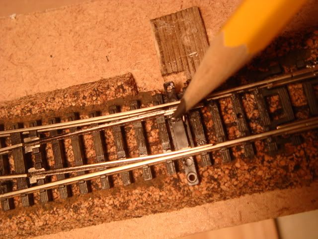

After installing some N scale Atlas 80 custom turnouts, I had an “industrial accident” involving some CA. Using oil, I was able to work the points free, but one point rail came unstuck from the bar (at the pencil point in the photo.
point break
Any suggestions how to reattach the point to the plastic? I’m apprehensive about using CA since any drip will glue the throw solid. Thanks for "point"ing me in the right direction and not "throw"ing me for a curve!

Epoxy may work, but you may have a problem with it holding. If this is the case replace the throwbar w/ a PC strip. solder the rails to the strip. You have to file/ grind away the coating between rails to electricaly isolate the points.

Any adhesive will stiffen the point to the throwbar…not a showstopper, but not exactly ideal. How much work do you want to do?
You could drill out the throwbar at the contact point, solder a small wire pin to the point rail low enough so that it doesn’t foul flanges, and use the pin to sit in the throwbar. Maybe there is already a hole of sufficient diameter? In any case, you would be better to have the point able to pivot in a few degrees of arc to lie flush with the stock rail.
Never apply CA using the bottle as an applicator. I always put a drop or two on a plastic bottle cap or some small container and use a peice of wire to apply just the right amount of CA. This also works for the other adhesives. BILL
… and use medium viscosity CA. It stays put better than the thin.
Karl
