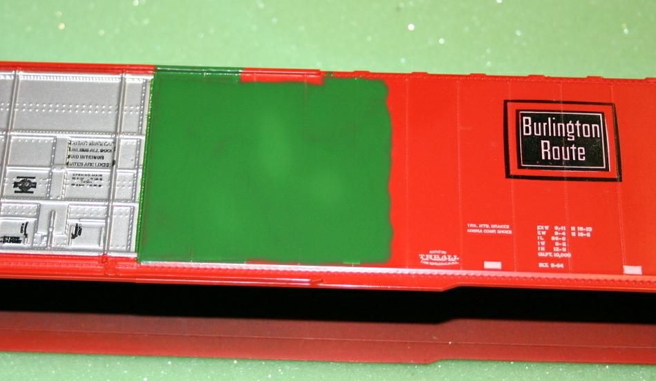

Well, here it is - I promised I’d post photos of the results of my ModelFlex hand-paint experiment. But I only managed to snap a single photo before my camera battery went dead [banghead]. I wanted to get a photo while some areas were still wet, and another after it completely dried; but I only got the partially ‘wet’ shot.
This is what a single-coat application looks like. The light-colored spots in the green are still wet, otherwise everything would be the medium shade. Some areas are a bit thin, primer would’ve produced a better result but I didn’t put any down - it wouldn’t have cured enough in the short time frame, and the ModelFlex paint would’ve reacted unfavorably with it, similar to the way milk curdles in lemon juice.
I painted the top door rail separately, after the paint adjacent to it had dried.
What the image doesn’t show is that there are zero brush streaks, and the dried paint surface is mirror-smooth gloss.
Definitely not an exact substitute for PollyScale, but with a little more practice, I believe I can make it produce the kind of results I want…
