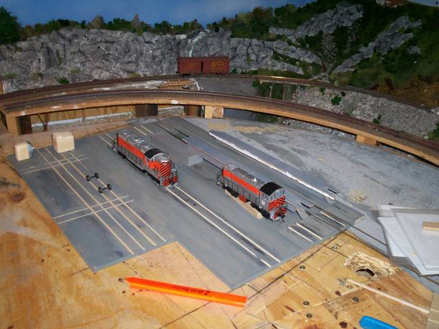

Wow…Thanks… now I will think over all the above. The two roof idea sounds pretty cool as im intendending a arc welder flashing gizzmo, Any how heres a quick shot of a mock up of it. Two pits or right are the elevated ones. Drop pit will be under the front of the GP9 about at the front of the fuel tank. The other end of the pit will be about where the wheel sets are.
Where the four tracks cross will be in the wheel shop will be circular turning devices, all tracks lead to doors. The wood block at upper left will be a tread lathe and is just roughted out. 100_2249.jpg
Of course the stuff in the elevated area to hold things giving you an idea of what Im attempting to do. No the concreat loading dock will not be in the elevated wheel area. Will make new service ramp and will save the stairs for them. Will have engine walkway ramp on the right wall and another in the middle of the two track.
lots of room for a fork lift moving parts around
May use n scale track as I have a lot leftover when I built some bridges.
Anyhow…hats off to you guys, Thanks again…John
