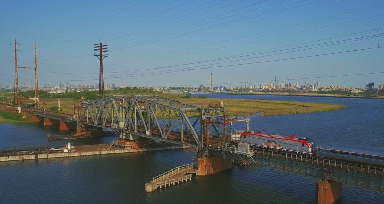

The gofund me aerial picture of the Portal bridge on the below link is interesting. As noted elsewhere the waterway transit thru the bridge opening is not perpendicular to the Amtrak tracks. That means a barge tow has to be careful transiting the bridge opening. Further is the waterway under the influence of tides ? If it is tidal maybe barges are only allowed to transit during certain tide times ? That might be one reason that there are strange different times that the bridge is asked to be open ?i
https://www.gofundme.com/replace-the-portal-bridge
EDIT With a single span over the river that is going to be longer than the present swing bridge the navigation thru the bridge should be easier except during construction and when the swing bridge is dismanteled ?

The reason for the new bridge is that there is a marina on the inland side and that garbage barges must also pass through.
The new bridge is estimated to cost 1 billion dollars. Judging by California High Speed Rail, the actual cost should be 2-3 billion.
How about we move the marina to the sea side of the bridge?
How about we buy a low-profile tug that can fit under the existing bridge?
Cost for the above two items? Less than a billion dollars???
THEN you don’t have to open the bridge anymore. And it can’t get stuck out of position anymore. And you don’t even have to pay someone money to do the bridge opening.
Apparently, they’ve been trucking the sludge for 5 years, anyway. And not needing to open the bridge for that. MIGHT just want to keep doing that.
Whole thing stinks! 3 billion dollars, and lots of people want their share.

Towboats on the Illinois Waterway have adjustable pilot houses that can be lowered to fit under fixed bridges. Visibility is pretty poor, though, when the pilot house is lowered.
7j43k: Remember the waterway was there first. Almost impossible to decrease clearance height. Plus the center piviot point now does not allow for standard coast guard passage width clearances. Lower clearances increase chances of water traffic hitting part of bridge knocking it out of alignment. There also is that inconvient bend in the waterway approaching the bridge,
Back to the thread. The Portal south question is still open.
Yes, the waterway predates the railroad. And, in theory, since it was there first, the users get to tell the railroad to suck it up. That’s the theory. I suspect the facts are as I stated: one marina and one sewage plant. Make a nice new marina on the sea side. Deal with the sewage plant. Done. Traffic won’t hit the bridge because there won’t BE any.
Note also that the bridge won’t be rotating anymore, so keeping it in alignment will be easier.
The inconvenient bend has always been there.
If it’s REALLY inconvenient to run the barges under the bridge, they can keep trucking it, as they have since 2014. Hell, why not put a spur over to it, and ship it by rail? GOTTA cost less than a billion dollars.
The “thread” is “Portal Bridge and Gateway Tunnels”. I’m talking about the former, so we’re still in the “thread”.
I have yet to hear a good reason to re-do the portal bridge.
I’m waiting.

Ballasted deck and constant-tension cat without weird breaks are reason enough to re-do the crossing.
Doing it as two tracks where there should be at least three (and then leaving out Portal South, which would be another two, for who knows how much later) is goofy. But of course so is redesigning Gateway to be a longer, slower version of the existing tunnels, or giving up even the semblance of high-speed service from the west into Manhattan.
If the bridge don’t rotate anymore, then just run the cat through without breaks.
Ed
Running constant-tension catenary requires new supports and removal of the old, probably an adventure on the existing structure. Still doesn’t get you ballasted-deck in low-maintenance structural materials.
Surprised someone hasn’t posted to dredge the channel so vessels can ride lower [/sarcasm]
Silly! THAT won’t work. But LOCKS would! Yup. We’ll build a lock on either side of the bridge. If you make each long enough and wide enough for a Post Panamax container ship, it certainly will also cost billions (a big plus). And you can save a really cool historic bridge.
Win, win. As we say.
Actually, they WOULD have to dredge under the bridge, so your suggestion is appropriate. Thanks to your inspiring lead, we have an alternate solution.
Also more good news: the bridge foundations would be weaked by the dredging, and would have to be extended downwards or replaced completely. Hundreds of millions, certainly.
I think we’ve got an even better and more productive solution here than the uninspired “causeway”!

True. I wonder how much savings in maintenance would be realized, compared to the cost of the new bridge and trackage.
Ed
The Portal Bridge has a 23’ clearance.
Here’s some material on retractable wheelhouses:
http://industrialscenery.blogspot.com/2014/05/variable-height-pilot-houses.html
Here’s a video taken from the tug Frances, in New York Harbor:
https://www.youtube.com/watch?v=i1ZXtohfB_Q
I see ads for retractable wheelhouse tugs and tow boats for around $100,000. Notice that that is less than a million dollars. It’s less than 10 million dollars. It’s less than 100 million dollars…
Is this project really the best way to spend a couple of billion dollars? I do not see the need.
Except perhaps to “distribute the wealth”.
Ed
A swing bridge is by definition a navigational hazard and a replacement bridge would definitely be in order, probably a vertical lift. As far as moving the marina, how much might it cost to acquire property for a downriver location, plus the cost of a new facility?
Well, if it didn’t swing anymore because it didn’t have to, it wouldn’t be a swing bridge. Anymore.
From an article in the New York Daily News of July 21, 2021, based on Amtrak bridge logs for the period from August 2020 to June 29 2021, the bridge opened seven times, all of which were apparently related to construction of the new bridge. Without this, it appears the bridge wouldn’t have been opened at all for about a year.
So, in a way, it’s already a not-swing bridge. Just finish the job.
The new marina property could likely be paid for by selling the old property. The cost would be the construction of the new marina. I’m guess a goodly bit less than a billion dollars, even with the new bar with complimentary drinks for life. That little element will certainly win approval from the users of the existing marina.
Ed
Swing bridges that are no longer permitted to swing - can be dangerous to railroad operations. The Amtrak incident with the Sunset Limited near Mobile, AL that killed 47 people was because a tow barge, lost in fog struck the Bayou Cannot Bridge, a former swing bridge that was no longer operational as a swing bridge, and knocked track out of alignment.

I am seeing the word “unsecured” there. And more. I propose securing the Portal Bridge when making it non-rotatable.
Ed
