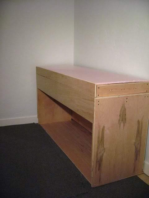

I’ve finally finished my “bench work” which is, really, as you can see, a large box. I haven’t installed the lighting behind the valance but there is no hurry on that because it’s going to be a long time before I am ready to be dealing with the backdrops on the ends and back. As the next photo shows, after I got it all together, I took the “lid” off to expose the foam. I’ll work on it this way for some time using the lid as my table for now. The track and wiring is going to be easier to install this way.

That’s a good looking cabinet. I remember seeing the discussion of your plan a while back and am looking forward to seeing the finished product. Good luck! :slight_smile:

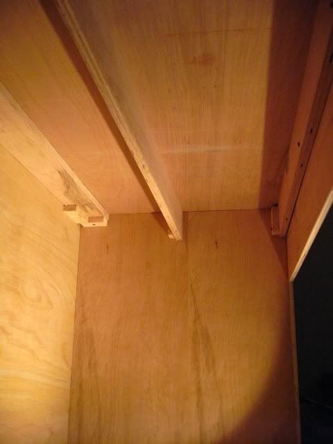

Oh: I would be interested in seeing the inner details of your benchwork if you wouldn’t mind sharing info and a drawing or two.

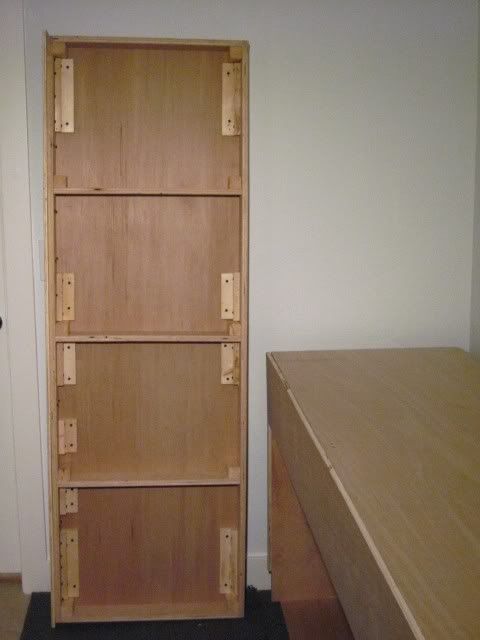

Here’s a photo of the frame under the pink foam. I used ¾ inch plywood cut to 3 ½ inches wide with 2 x 2 blocks to screw and glue the frame together. Then, in case I wanted to remove the top from the frame at a later date, I screwed the ½ thick plywood base, to which I will glue the foam, from underneath using L’s made from 1 x 2s.
Next, I attached, with screws only, to the two end pieces, ¾ inch plywood again, to the ends of the frame.
Then, I placed 3 stringers between the ends using ½ inch plywood cut to 3 ½ wide. To these I then attached top which is both ½ plywood. The back is the same and is screwed to the back stringer to which I screwed and glued some 1 x 2 blocks and also screw to the back side of the frame.
All that was left then was the front. I used ½ plywood for the valance at the top. It’s about 12 inches wide and should block the viewer from seeing the lighting I’ll install on the center stringer. The front of the frame was concealed behind another piece of ½ inch plywood glued then screwed from the back. Finally, I cut two ¾ inch wide strips of ½ plywood to cover the front edge of the ¾ inch end pieces.
Once it was all together, I took it apart by removing the screws that attached the ends and back to the frame.

Nice carpentry. I can visualize that being a very nice layout when it’s finished.

Very nice work. I missed the discussion on your plan, but it looks very good. This should be a fun railroad to build and operate, and look good as furniture, too.
Thanks for sharing the details. Looks great and I look forward to seeing how things turn out. Good luck with it!
