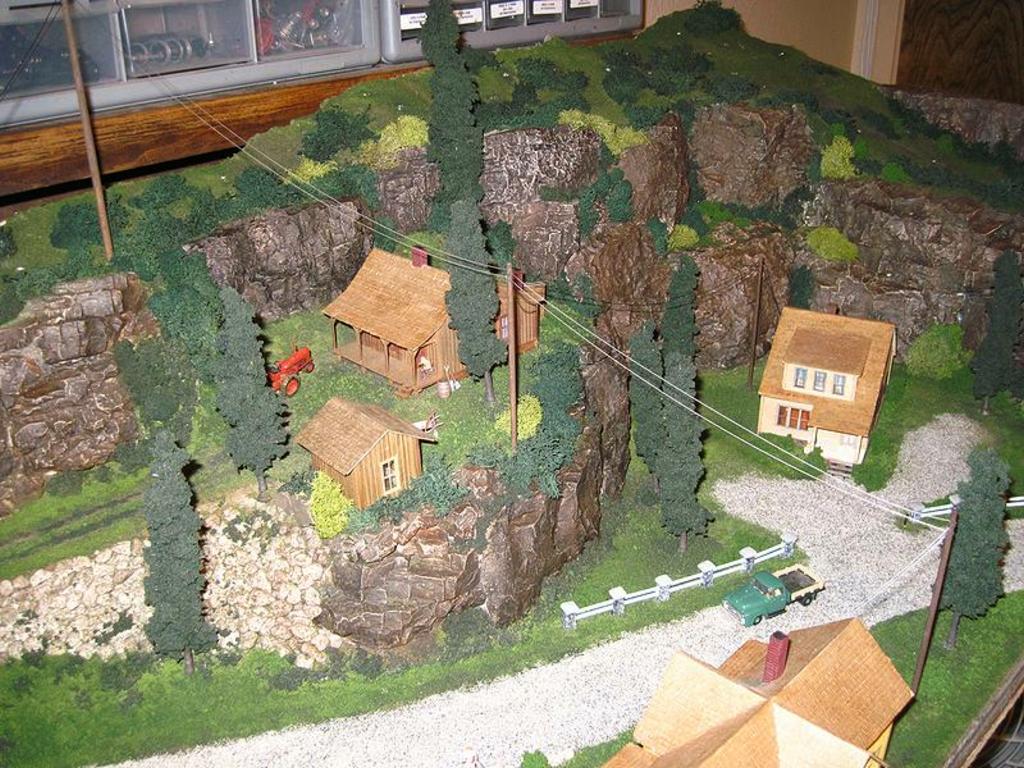

I have had my best results using 0.010 brass wire.
It looks great in pictures, but is damaged easily.
-Kevin
Thanks for the idea of using wire. I really need something grandchild proof, if there even is such a thing.
I use .010” or .015” piano or music wire. Drill #78 holes in the polls to drop the wire into. Wire works better then thread or nylon, all attract dust and webs but wire is easier to clean.

Thanks. I can see where using wire would last longer. will the wire sag by itself or will i have to bend it ?
My 9 year old grandson saw the picture and said to tell you that looks really cool.
I manually put the sag in the lines. Another reason I went to the piano wire is for ease of removal for maintenance around the area. I’m Clumsy Mel and it’s easier to remove and replace the wire (and polls) than having to make new ones.
