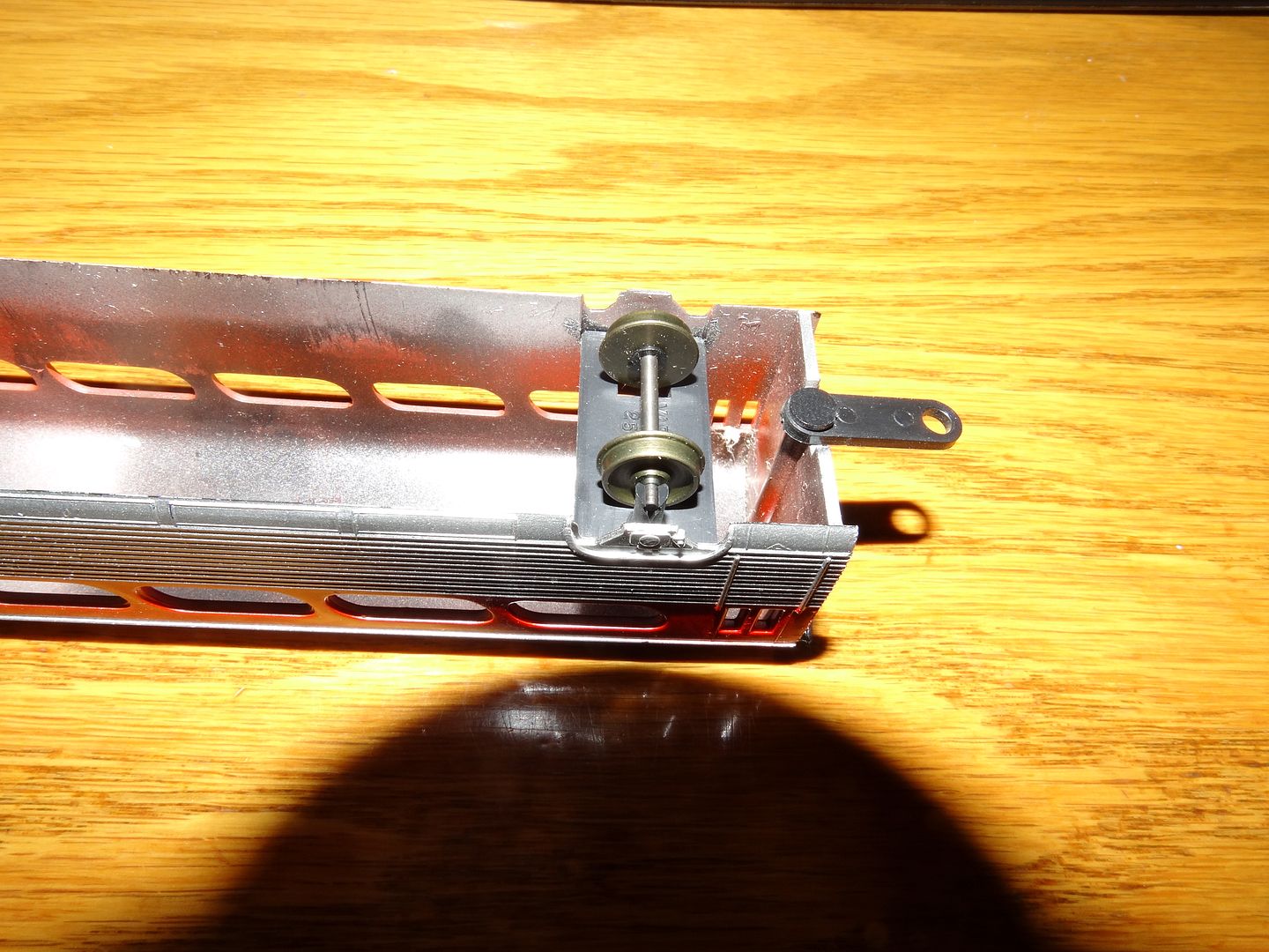

I have a couple of the original Varney locomotives and several cars. I don’t know if the Bowser cars and the Varney cars used the same wheel mounts, but if they did, NWSL makes replacement wheel sets that fit nicely. They are NWSL #37108-4, 36" scale wheels with a 110 tread and stub axles. I had to trim a bit off the insides of the wheel mounts/axle holders to make the wheel sets fit but there is still lots of material left.
Here is a picture of a Varey car with the NWSL wheels installed:
