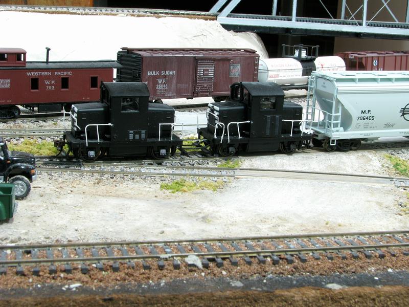

I went the other way around the barn. I wired these two locos together.
Years ago, I did the same thing with two Penn Line Whitcomb Diesel switchers. Another solution is using an idler car wired for extra pickup. Peter Smith, Memphis
