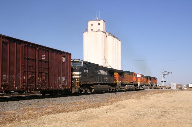

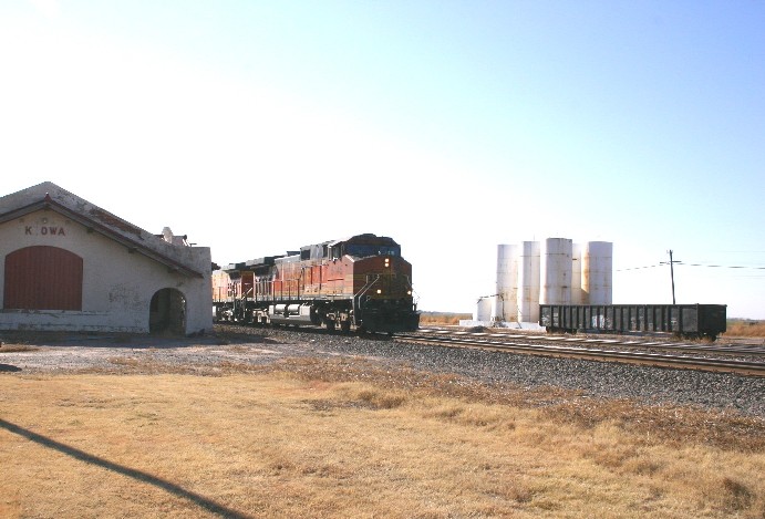

But here are two shots taken in Kiowa Kansas. Look at the horizon in the background of the first. Then I panned with the train to the grain elevator. You can’t see the horizon but other than the supporting structures to the elevator it looked the same.

Most people think of relieving the faltness by building UP, really the more common answer in the prairie is building DOWN.
From looking at the pictures, assume the flat plane of the plain is datum. The railroad is set up on the ballast section. Everything else will be down. There will be ditches along the roads, small washes and creekbeds every so often (lined with cottonwood and willow trees). There might even be a spot where there is a railroad bridge over a highway.
Easiest way to model this is to cover the plywood with foam or homasote, then put the track up on roadbed, 1/4 in or so higher. Then cut down to theplywood for ditches and washes, cut all the way through the plywood for streams and rivers. The plywood will give you the flat prairie, but the ditches etc will provide a sense of depth.
Look carefully at the horizon. It is most certainly NOT flat. Nearly so, yes, but not perfectly so. The RR grade, being in the foreground, has its relief emphasized at the expense of the distant terrain.
