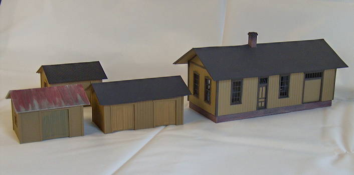

I ended up scratch building a 6 unit false front structure in my 1910 theme.
It, and the other buildings, are not glued down yet (just sitting on the ground).

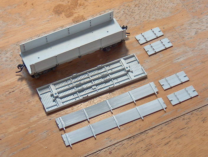

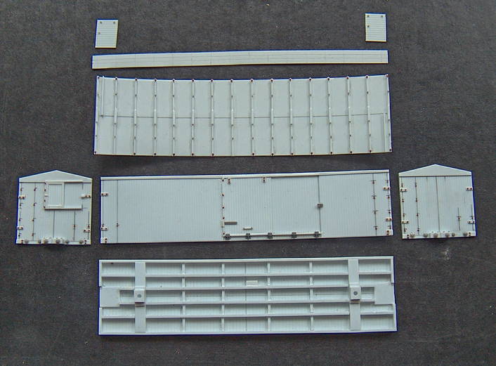

Remember that scratchbuilding is your friend. Scratching in plastic is simple, time-friendly, and generally pain free. True, there’s a learning curve as with anything else, but the curve is fast with plastic. If you can build a Branchline freight car, Roundhouse steam engine, or resin freight car, you’ve got all the skills necessary to scratch.
And since basically NO manufacturer really supports the pre WWI era, you almost HAVE to learn how to scratchbuild!
Those cars look great - are they cast, or built up?

The cars are completely scratched (well, except for the NBW castings and trucks!), and will eventually become resin kits. The top car is an 1895 34’ box and the gon is an 1890 MP&N car. Both are standard gauge.

Are the holes in the chassis for truss rods like in the MDC models?

Those two gons took me about six hours to do, over three days (Fri-Sun). I’m heading over to the LHS tonight to pick up more NBWs and queenposts to finish them!
The holes ARE for the trussrods. The plan is to use 5# fishing line for the rods, with threaded on Tichy turnbuckles. Once the ACC is dry, I’ll add a sub floor of .010" V-groove siding for the “real” floor.
After these cars I’m planning on doing a 28’ or 30’ drop-bottom gon. Those are what you really need for your mine runs, but they’ll be a but tougher to engineer for a resin kit!
