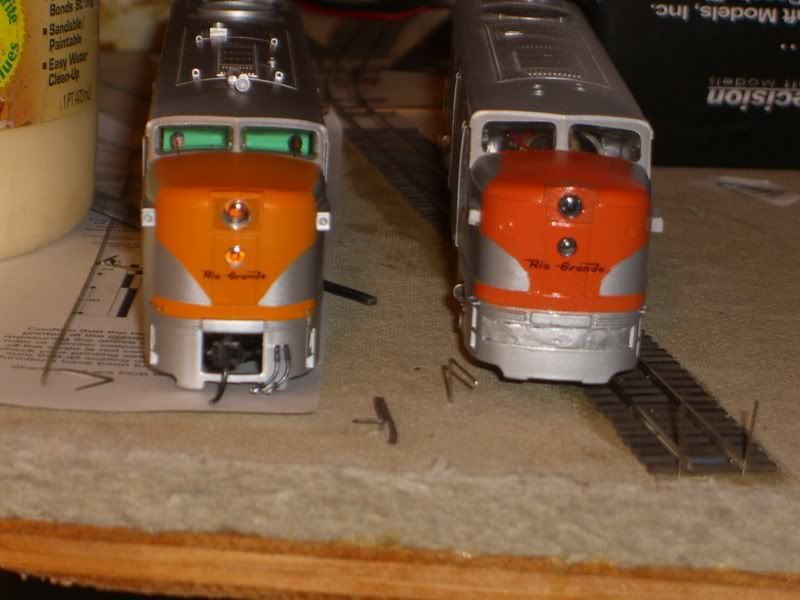

Anyway, I haven’t been able to see my PCM Units again until today. I have another set of PA’s in the roughly the same scheme but I accidently used Anshutz Orange instead of the Aspen Gold. There is a very noticeable difference between the two. The PCM unit are much more yellow but at the same time they are not exactly the same as the prototype. Below is a comparason between the Anshutz Orange that I accidently used and the Gold PCM used.
The one on the Right is an Athearn with Rio Grande orange. The one one the left is the PCM gold.
While not exactly the same used on the prototype it is closer to the prototype color than to the Later DRGW (Anshutz) color.
