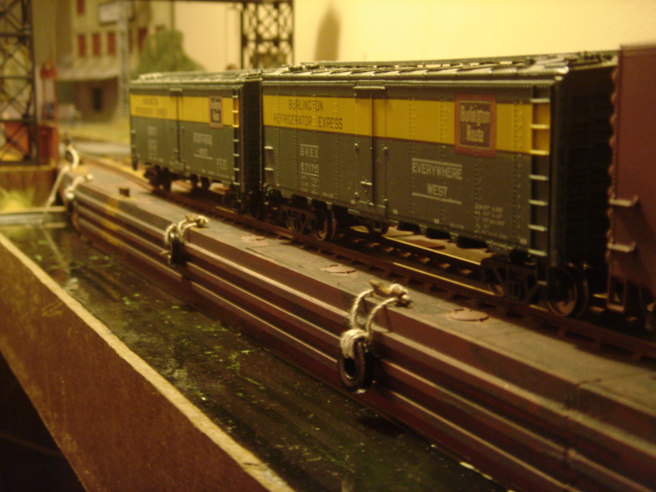

I’ve got two scenes with waterline models. This one is a carfloat. The float was glued to the base, and Envirotex was poured around it.

The carfloat, of course, has to mate precisely with the tracks on the apron, so repositioning isn’t desireable. I like to move the lobster boat around once in a while. A waterline model lets me do that, and it also give you the option of waiting until the end to decide exactly where it’s going.

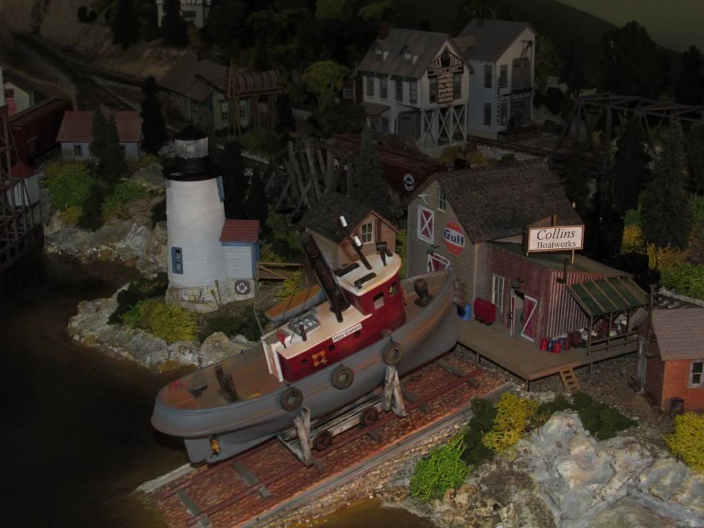

You mentioned an interest in modeling one of your tugs on shore for repair. I modeled something similar to that in my harbor scene.

Thanks to everyone for the ideas for the tug and coast guard cutter placement in the waterfront…Steam train,that pic of the tug in repair is perfect for one of my tugs,Forellaa’s idea of using the block is a great idea but so was floating in chaulk…Haven’t decided.I have a dremel and I guess I’ll use it on low as not to melt the plastic.I have built r/c scale planes and models all my life but this train stuff is unbelievable fun.The models are Linberg models also.Is one of yous guys really from DOWN UNDER.If so,GOODAY.Thanks again.I love all your help.DOC
