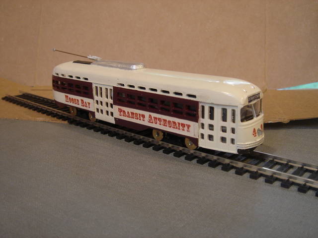

This is a trolley I did for my own Moose Bay Transit Authority. I found a font online (“Saloon”) and used it to print these decals using MS Word. Note that the decals are dark, and the background color is light:
For anyone who is saying, “Oh, I could never do that. It takes years of practice.” I say “Bunk.” This was my first try. I was pretty clueless. Other than seeing my first decal instantly dissolve when I put it in water (See Rule 2 above. How do you think I learned this?) I succeeded while pretty much flying blind and enjoying the learning process.
