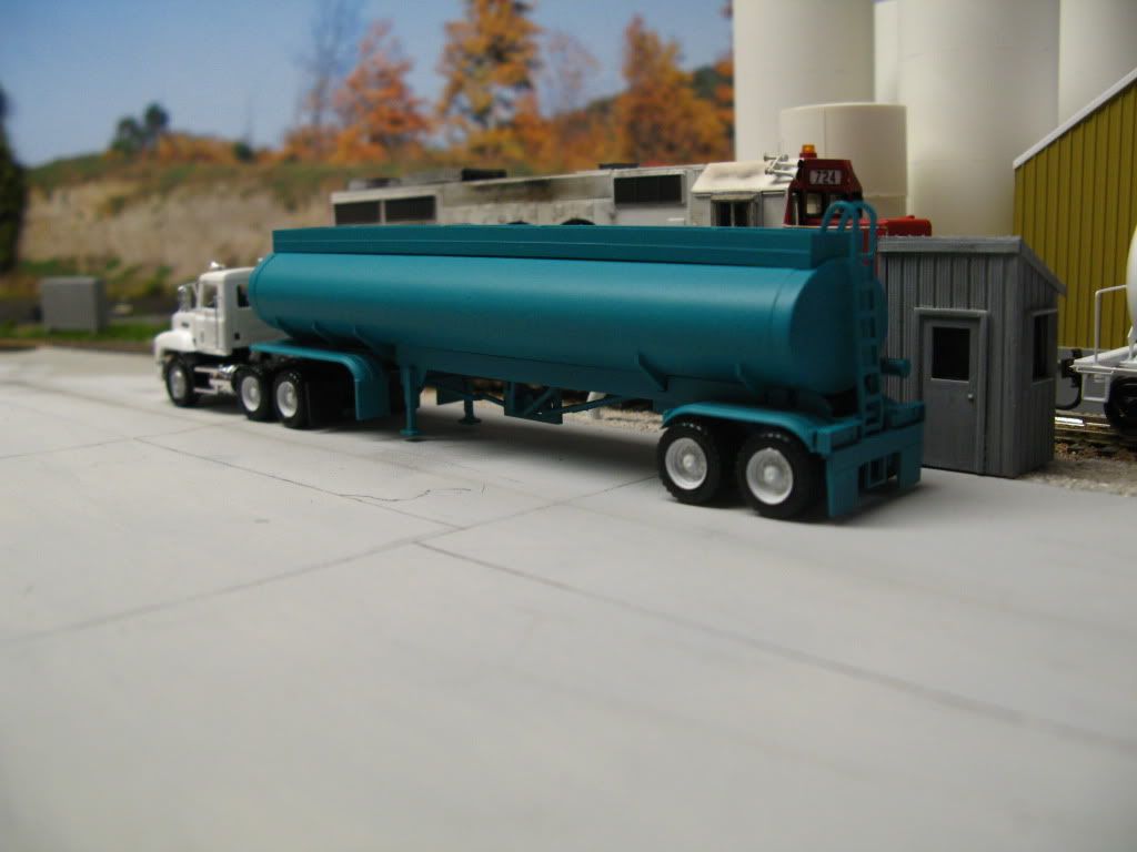

I need decals for my Barsol chemical trucks I just painted.
