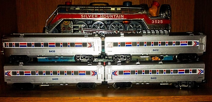

I switched from passenger to freight today so here are the 4 phase 1 “heritage” cars I have.
Vintage 2400 types, nice! And with the old “Headless Arrow!”

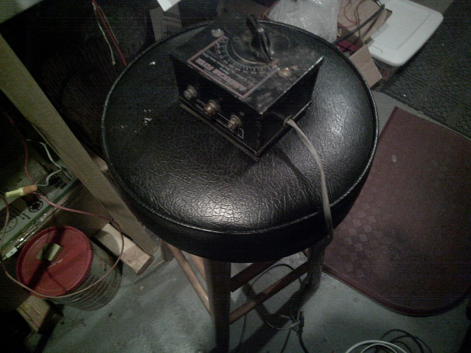

Firstly, there’s this neat DC power pack, which was part of a $35 lot. It doesn’t work, but it appears that someone rewired it without bothering to find out what a wire is, and so I can probably put it back the way it should be.

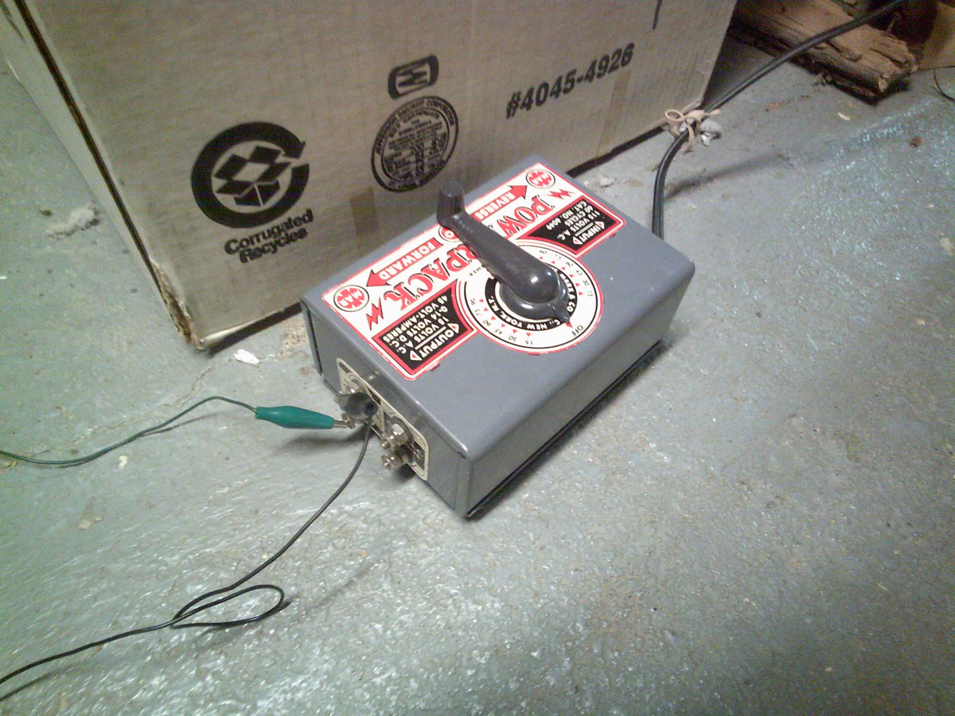

Then there’s this Marx DC power pack. It acts a little hinky; I’ll have to open it up and take a closer look. But it’s likely nothing I can’t rejigger! It was the other half of the $35 lot.

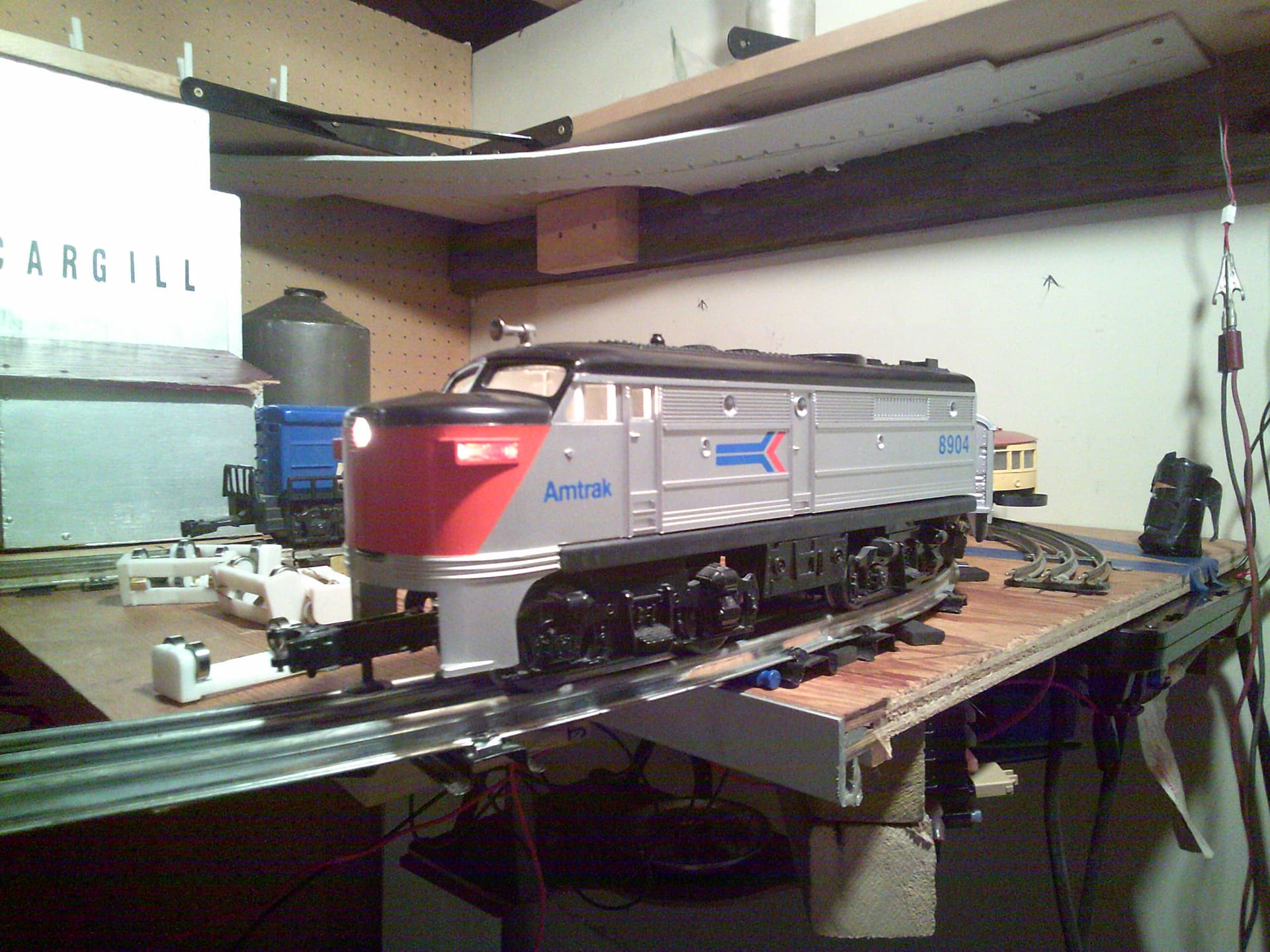

Then there’s this Amtrak FA-2 I found to pull my Amtrak train. It was fairly inexpensive for a can-motored loco, but that’s because it was missing a gear on one truck (it runs fine otherwise). I’ll probably 3D print a new gear.

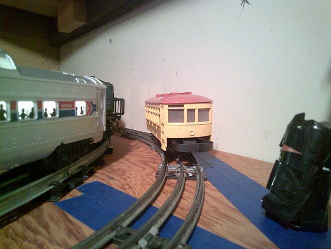

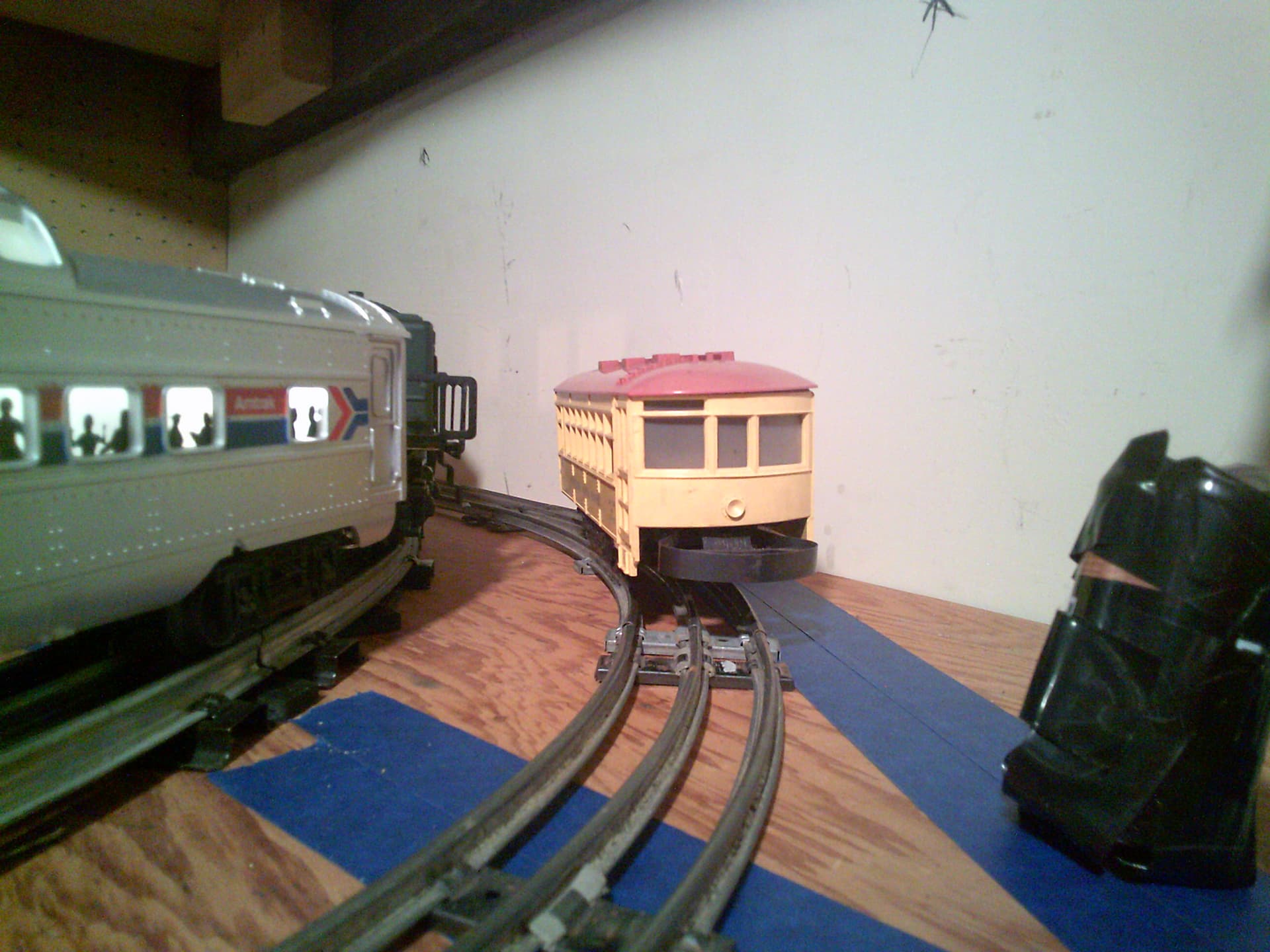

Then this is the trolley I got way back before Christmas and only just now remembered to photograph.

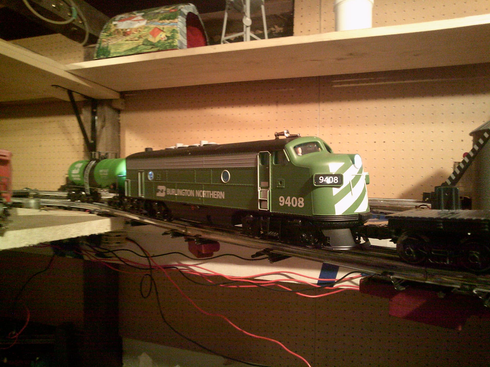

And then we come to the big thing I bought: the Menards BN FP-7 A-A set! Yes, I’ve got the other locomotive, it just wasn’t in a good spot for a picture.
In my opinion, they definitely improved on the original–which was quite good to begin with. Mostly in the realm of sound effects.

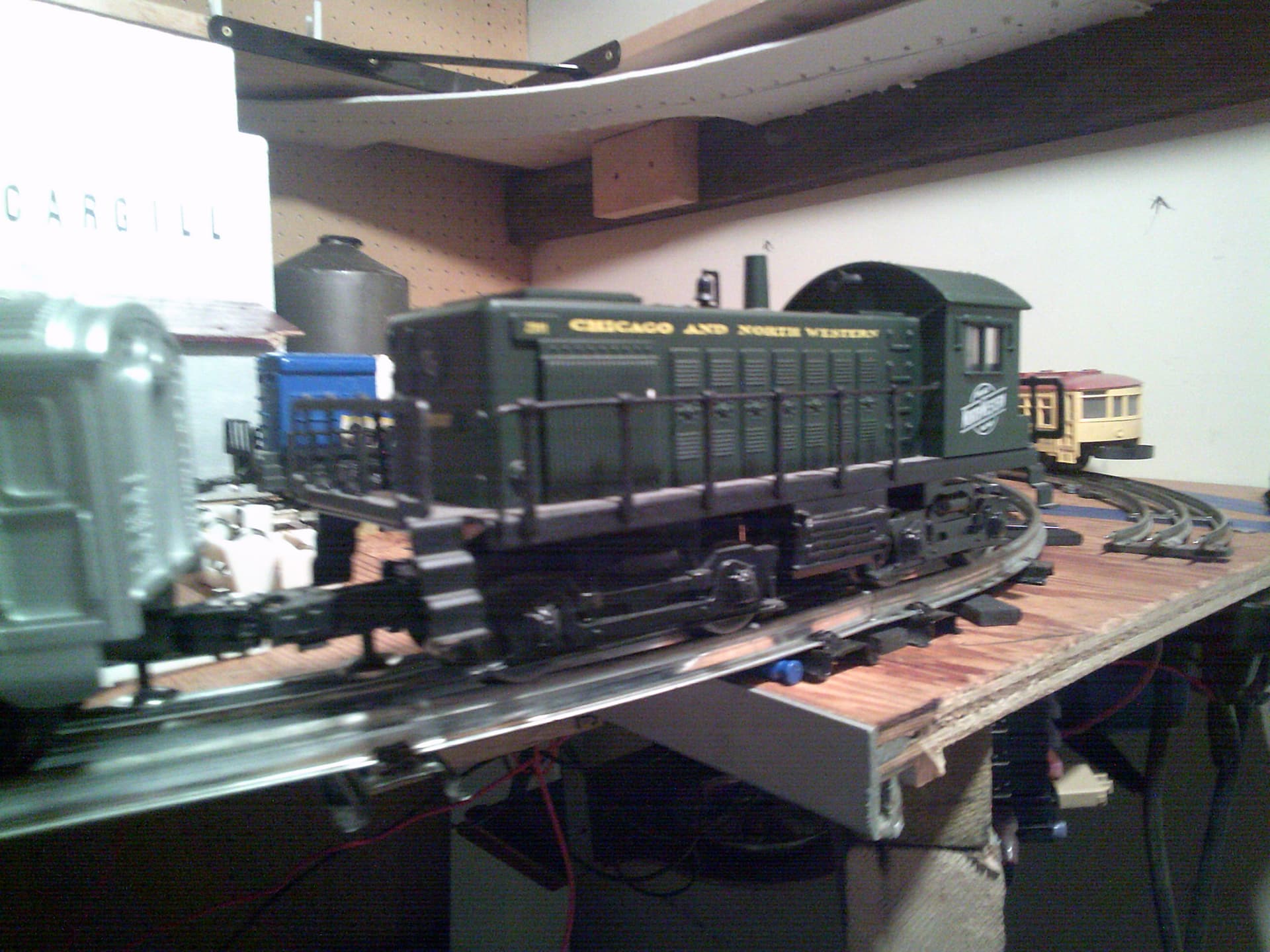

And I picked up this nice K-Line Alco S-2 switcher. I’ve been wanting to get one of the Marx/K-Line/RMT Alco switchers for a while, and here was one at a decent price!

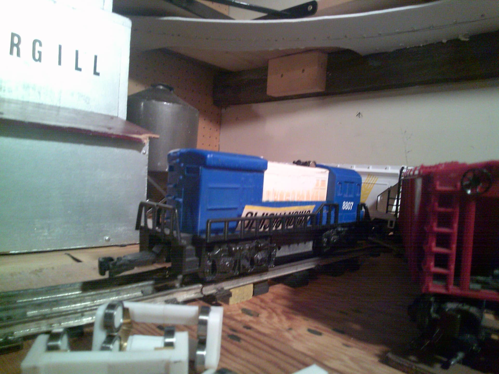

You may recall that, not long ago, I picked up a Marx-Tronic switcher for $10. Well, at Trainz.com, I found the whole train set for (I think) $25 or $30. It had everything (even the box) except the loco. So it was perfect! The track did have some broken bits, but nothing I can’t fix with a little glue and a little PLA filament… And then, for some bizarre reason, it also came with this Durham clockwork loco. Didn’t really need it, but I’m not gonna say no! As you can see, the label has come off, and it’s not in very good condition cosmetically otherwise. However, the handrails are actually quite lucky–while they are broken (as is, apparently, common with these), they’re hanging on by a “plastic thread”. I might be able to salvage them with some good plastic cement, or maybe E6000. Of course, even if I wasn’t looking for it, now that I have it, I’m gonna do everything in my power to make it nice. The clockwork motor does, in fact work, but (as is apparently also common with these) the motor cover catches on the third rail. Of course, there’s no way I would’ve been able to recognize the loco if I hadn’t have had read this most interesting thread by JamesP

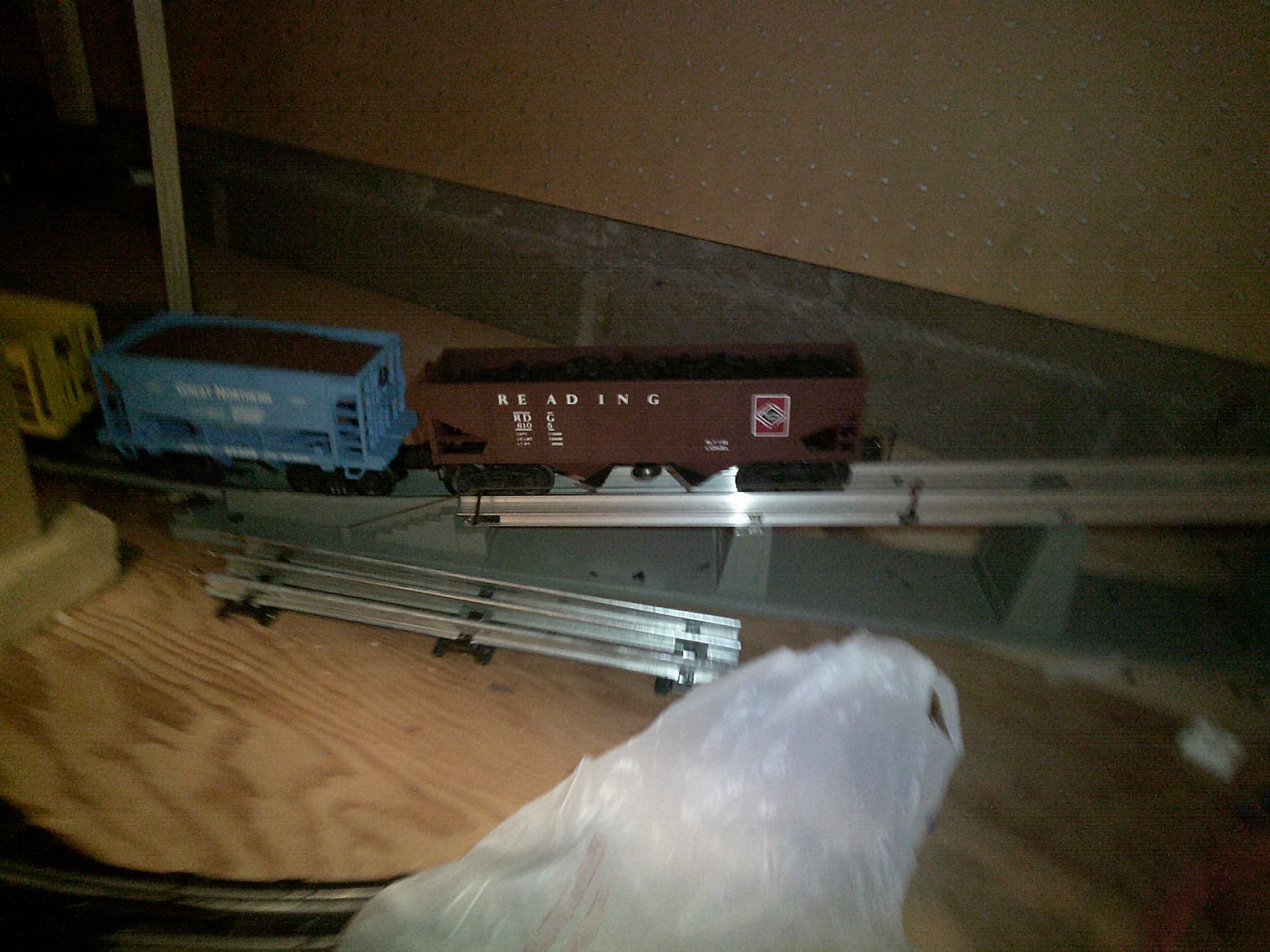

Then there’s this nice Reading operating hopper I got–I think that it was close to $20. Although I’m showing it here on the coal ramp, it doesn’t actually work on the coal ramp. But that’s fine; I only need one hopper there anyway. It does have very nice sprung trucks… that are very free rolling. So free rolling, in fact, that a small shove from my new Alco S-2 will send it rolling freely down the line… and down the helix… and into a piece of junk set on the helix. The car itself is fine, but I had to pick up a lot of coal.

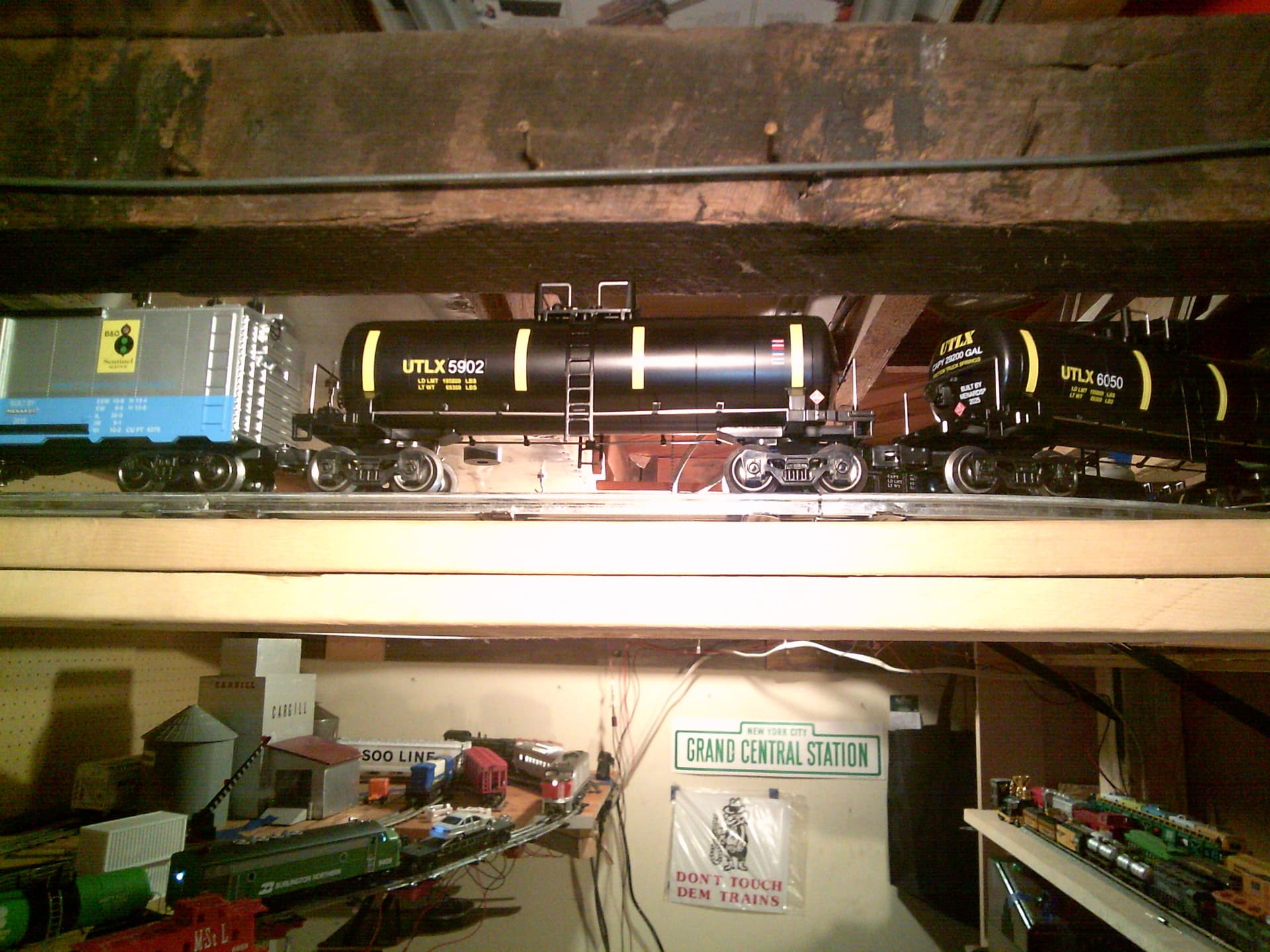

I also got six of these Menards tankers. They’re probably the only cars on the whole railroad that actually fit the theme completely, with the exception of my big SOO Line hopper.

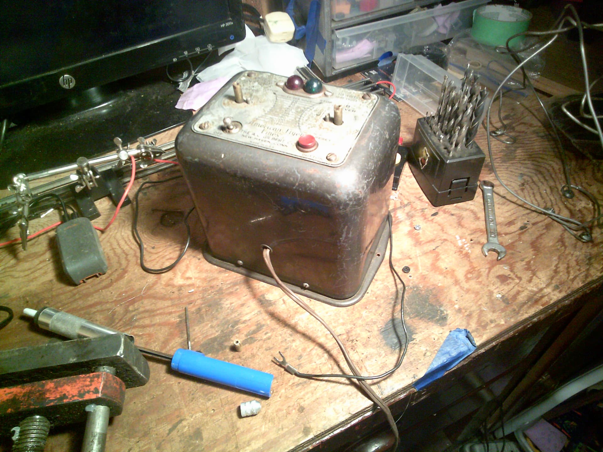

You may recall a while back that I managed to obtain a American Flyer 18B for $20 that would have worked if Fedex hadn’t smashed it. As you can see, I managed to (messily) epoxy it back together–and it works! I believe I had mentioned my plan to use my Lionel Type VW for my test track, however, the 18B had better voltage characteristics. Also, notice the ammeter (above the drill, it’s the little clear box)? That’s a DC ammeter that I made work with AC by way of a rectifier. If anyone wants to know how to do so, just connect the ammeter across the DC terminals of the rectifier and then connect the AC terminals of the rectifier in series with the track. Since this drops the voltage a little, I wanted to use the 18B, which puts out like 19.5v, whereas the VW puts out more like 17.5v. While on the actual layout a nice voltage of 16.5v is best, on the test track I’d rather have 18v–which the 18B accommodates nicely after the 1.5v or so voltage drop of the rectifier. As for the whistle control, I’ve got a plan for that too. But since the 18B has an on-off switch built in, it’s perfect for the test track, because I can leave it plugged in all the time and just switch it off at, well, the switch.

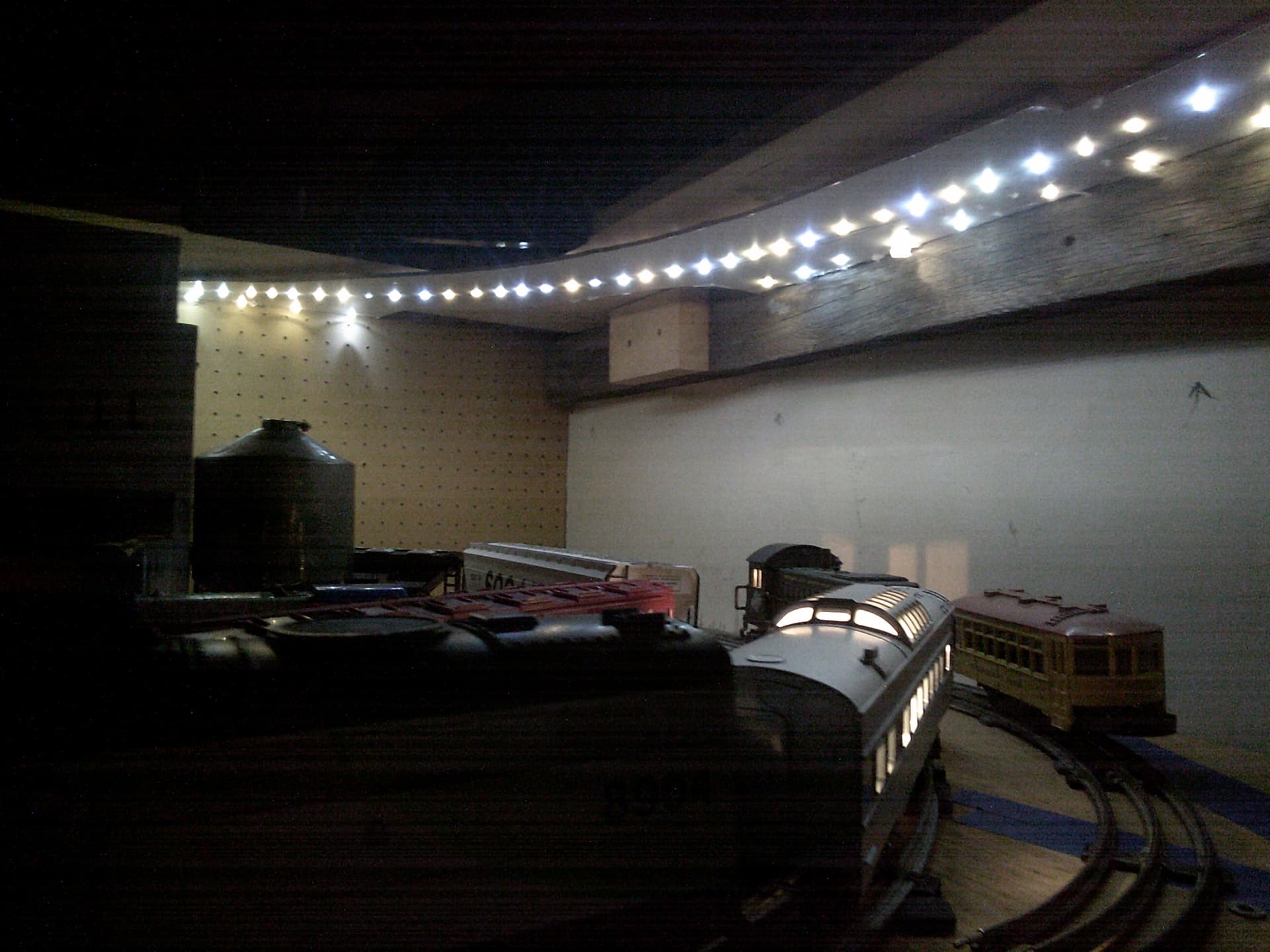

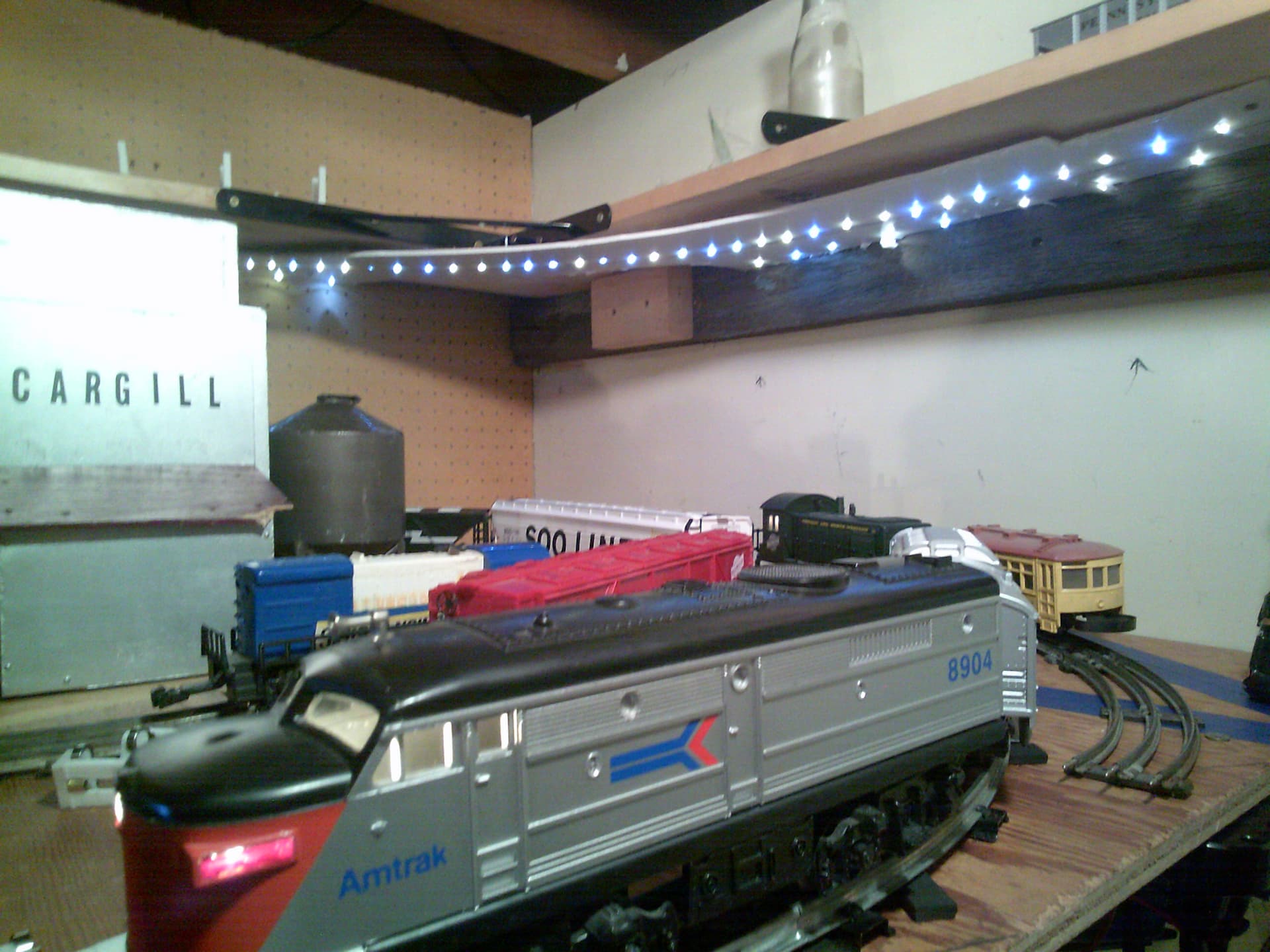

Some of you may know that I have been working at the abbey to help disassemble BroadwayLion’s impressive subway layout–a sad task, but it does have to be done. Anyway, he had quite a few subway stations that were scratchbuilt and lighted. There was not much hope of selling them (and most of them could not be removed from the layout intact), however, the monks said that I could have the individual components–which meant that I was able to have the lighted roofs and the like. Now, since I neither model HO nor subways, I couldn’t turn them back into stations–but I could mount the light bars to the bottom of my layout’s decks, so as to light up the layout more. So far, one has been installed, and more will be done soon, though none are actually wired up at the moment–that’ll come later. I would have rathered that the stations could be used, intact, on a layout, but at least this means that BroadwayLion’s work won’t go entirely to waste. :frowning:
But long term, I’ll have more of the lights mounted, thus illuminating the dark portions of the layout. I’ve got a few ideas for power supplies–if I’m lucky, I’ll be able to scrounge up a PC power supply inexpensively.

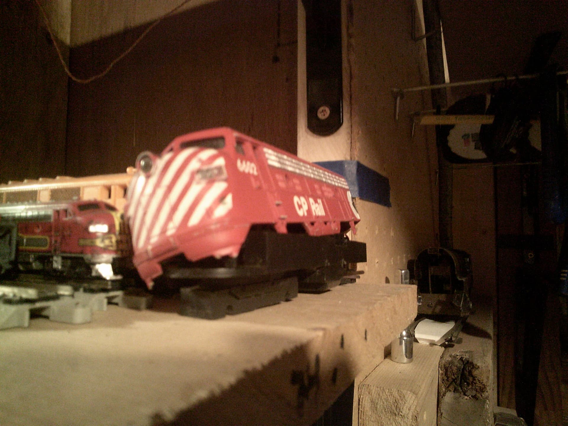

And, saving the best for last, due to the generosity of Kim, I now have this (partially disassembled; I was in the middle of working on it) HO F7… once I obtain the necessary replacement parts, it’ll likely be running–even now, the motor runs quite well!

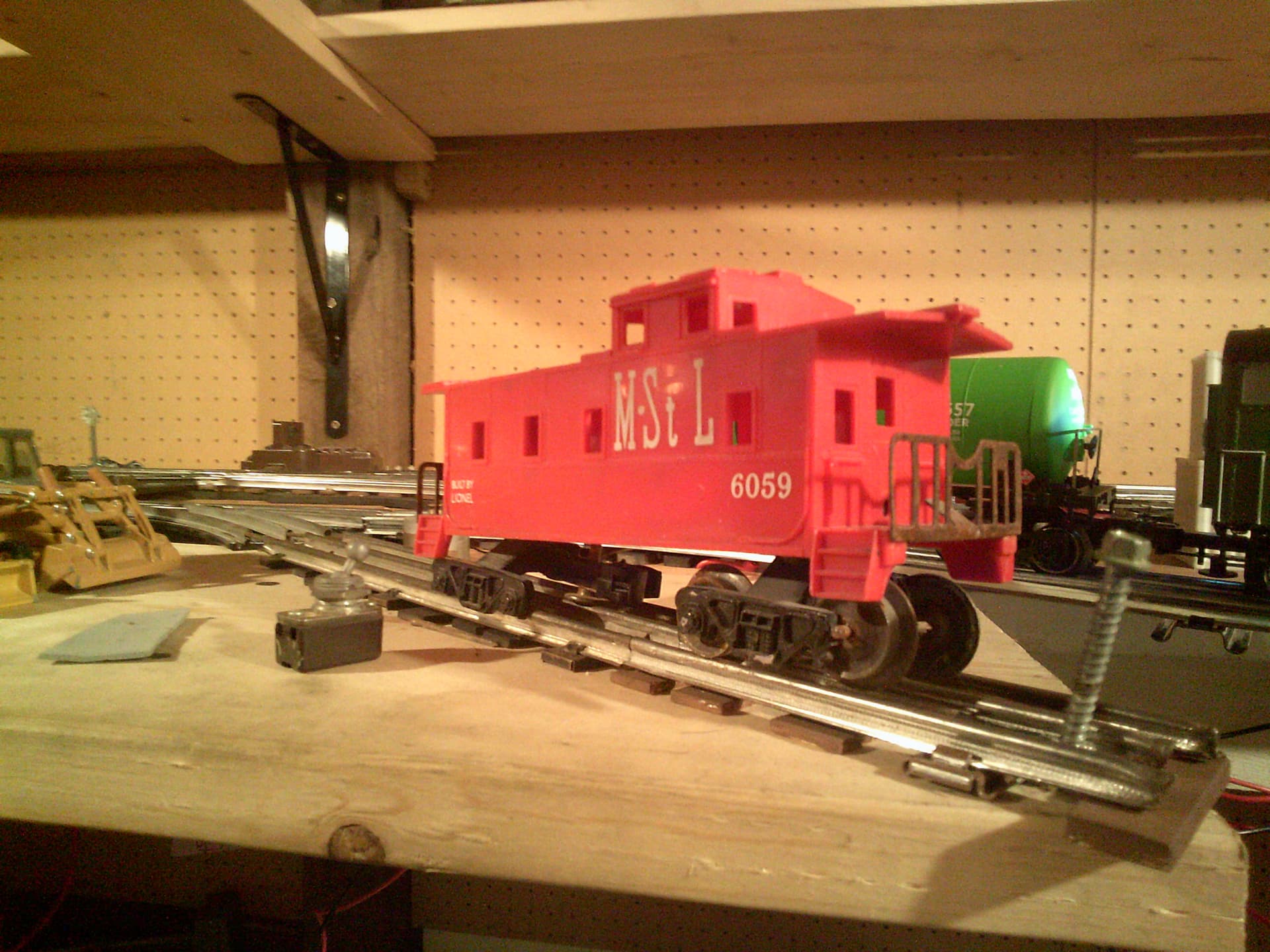

And, in the same line, there is this M&St.L caboose, which, as you can see, could use some new trucks. I did manage to obtain a whole box of trucks on Ebay, though all that I had really been after were the leading and trailing trucks for a steamer. Yet the lot included a ton of other trucks. I’ll have to see if I can make any of them work to replace the broken ones on the caboose.

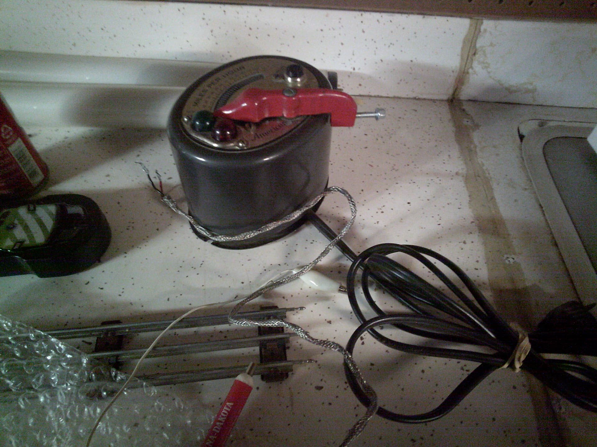

And, also in the same category, there’s this American Flyer transformer. It’s a 75-watter, which is a decent rating, but it is also rather puzzlesome to me. You see, none of the terminals seem to do what they’re labelled as doing, and the throttle works backwards of how it’s supposed to! Well, actually, that could just be because I might be using the 16V constant terminal as base instead of the actual base terminal. Otherwise, though, it puts out the voltages it’s supposed to–if you know what terminals to use… Either way, some investigation is needed, as is a new cord–or at least a new plug. The old plug is pretty badly cracked. But once that’s out of the way and I’ve solved the Terminal Mysteries, it’ll be another handy little transformer! Also from Kim was a landscaping transformer–a small one, but those are incredibly handy!

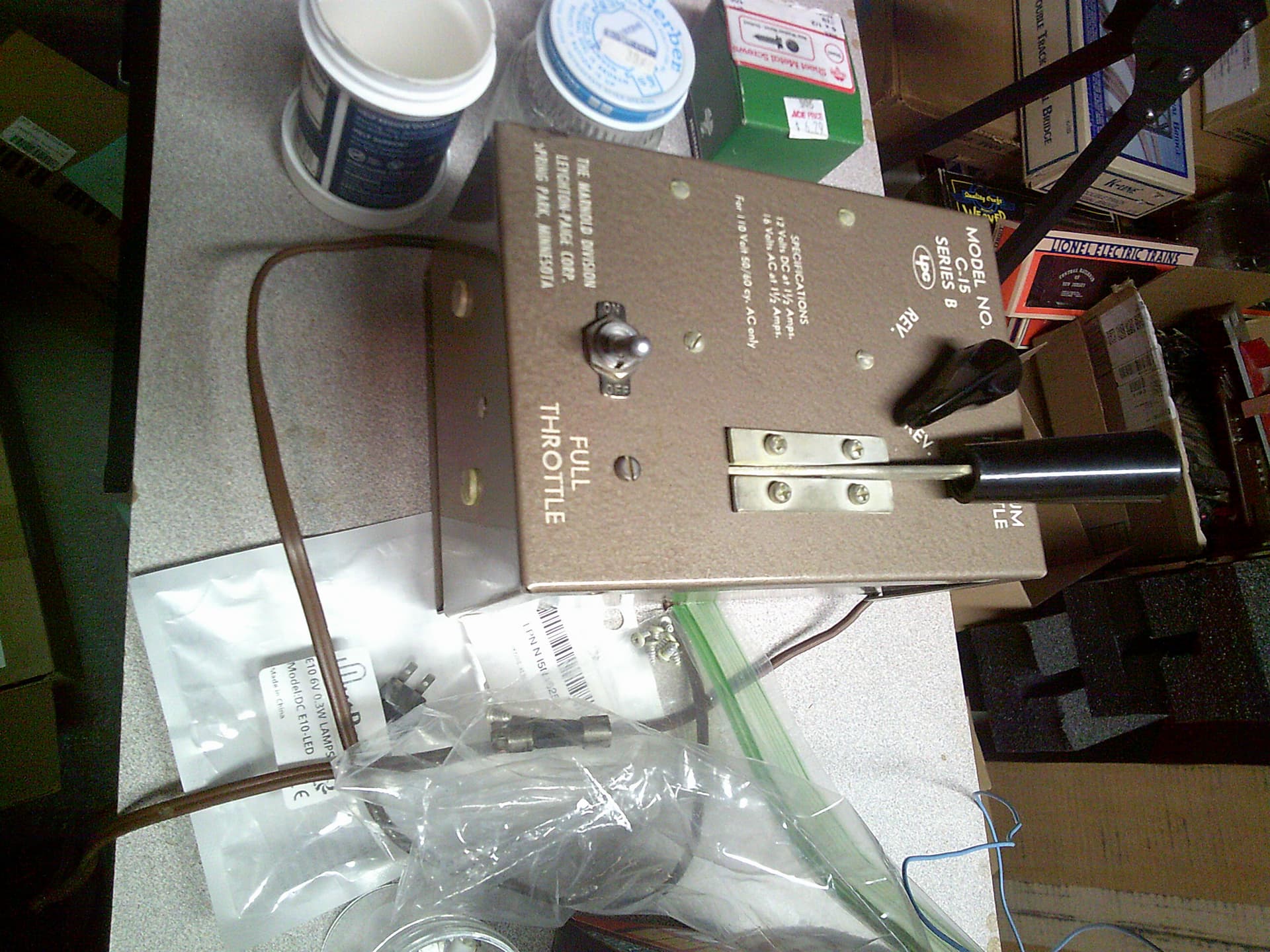

Well, I managed to get the Marnold/LPC power pack working–a brass contact was out of adjustment. For that matter, I also opened up the Marx power pack… seems like the only issue there was dirty contacts; it works fine now. And I replaced the plug on that 100-watt American Flyer transformer.
