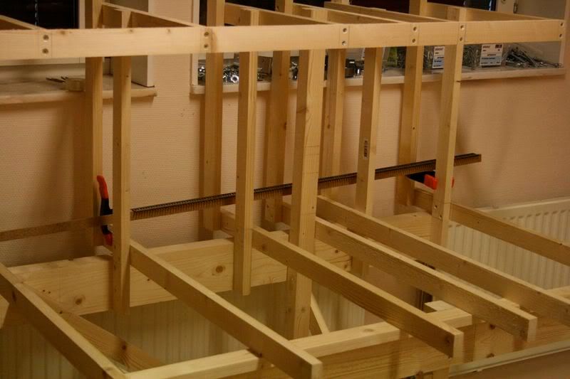

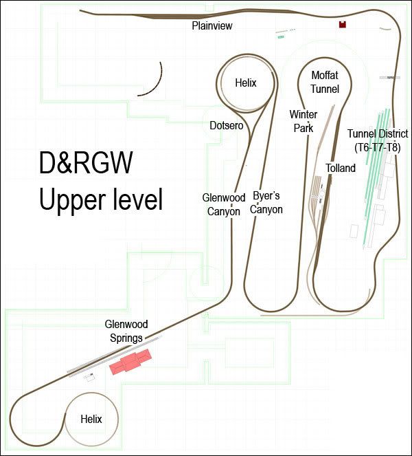

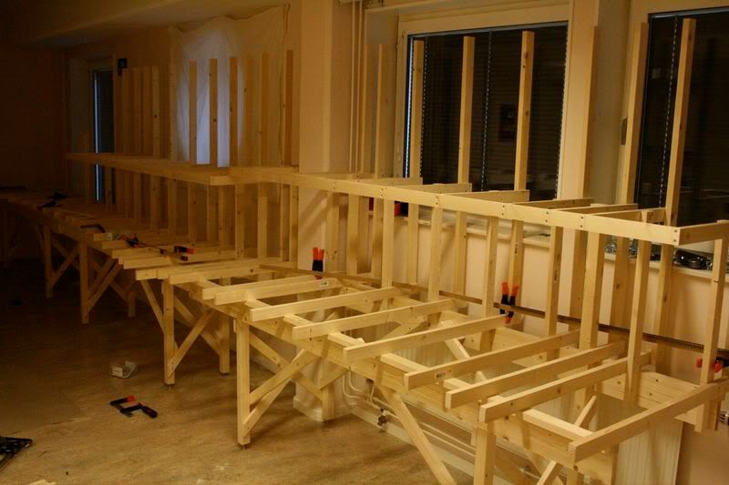

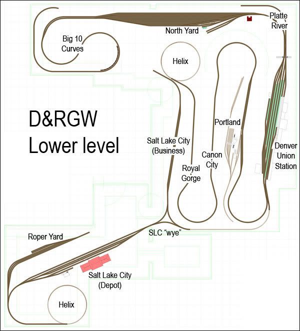

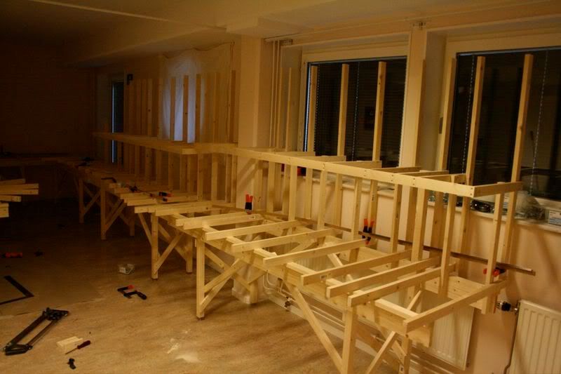

As you may know, I’m a Rio Grande fan. One of the forum members asked me about the progress on my layout. So I’m posting some pictures for you all to look at. It’s only benchwork building at the moment but as soon the benchwork you see in the following pictures is finished I will lay down some spline roadbed and track. Then I can run trains when continue building the rest of the benchwork. As you can see the layout have two levels except at Big Ten Curves. That area is used to connect the two levels.

Lower level trackplan.
Upper level trackplan.

Lots of benchwork.

is it just you building the benchwork or do you have a team ?

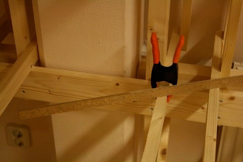

Very impressive, EL! [8D] Is that the beginnings of spline roadbed you show with the clamps and the lath running behind those uprights in a curve and grade? If so, how will you manage any problems behind the facade or scenery on the tracks behind them?

It’s only me. Lots of work but I like it. The benchwork you see in these pictures is a very small part of the whole layout.
Good question. The spline roadbed you see is the ramp down to the hidden staging yard. The hidden staging yard will be located under North Yard. I will reach the area from underneeth the layout.

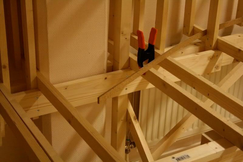

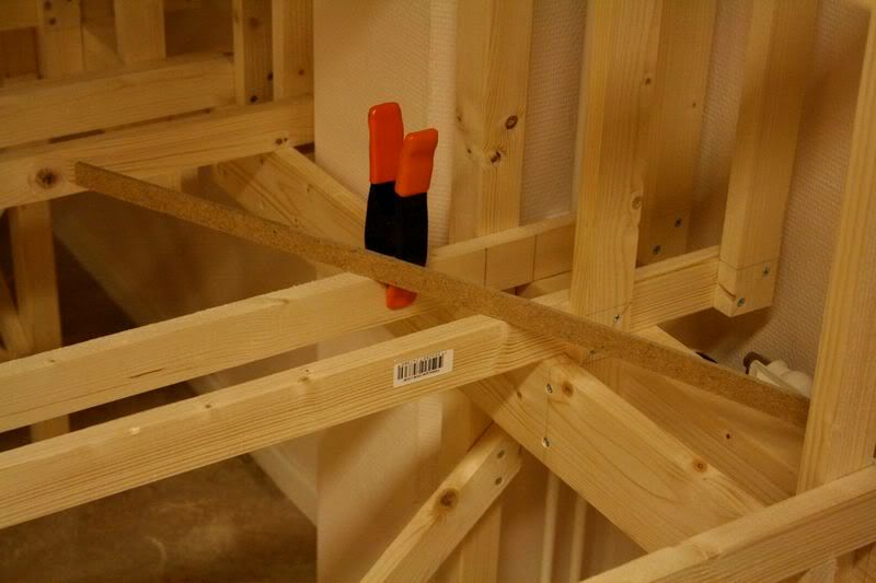

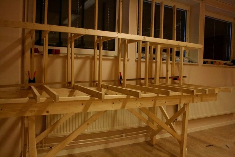

That’s coming right along there, Electro! Is the pinwheel of boards in the one pic where the end of a peninsula will be? If so, that’s an ingeneous and logical way to do that. [:)][tup]

Yes I will build the return loop there. I attached the wood in a circle for two reasons.
1 - It’s very easy to add risers for the spline roadbed and get a curve.
2 - I have something to attach the masonite fascia to. The fascia will be a circle as well.
There will in fact be 2 levels there. The lower level for the hidden staging yard return loop. And 20 cm above that the upper level for the Big Ten Curves return loop. That will make it even easier to attach the round fascia. The hidden staging yard return loop will be used to turn around the Rio Grande Zephyr F9, and to store trains that are not used at the moment.
Thank you much, electrolove; your doing a very good job. I can tell from your photos that your benchwork should have no problem handling the weight of your layout.
