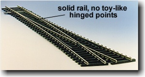

I will add Tillig to the list.
http://www.reynaulds.com/tillig/tillig1.html
More pictures of Tillig and Peco
http://www.modelrailforum.com/forums/index.php?showtopic=980&hl=tillig+elite
