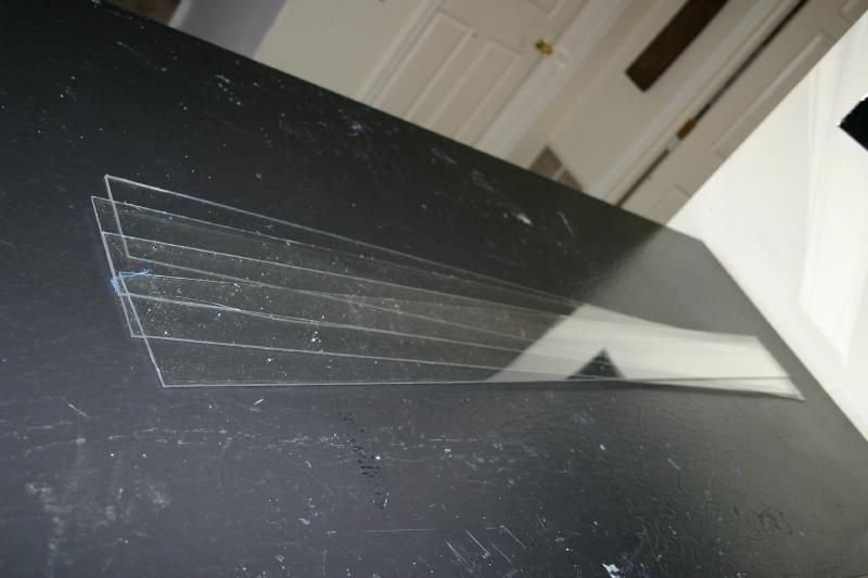

First, I went to my local Home Despot and bought two sheets of thin plexiglas, 48"x36", then sliced these into 4"x48" strips:
[NOTE: Since plexiglas is such a tough material, I had to scratch-over each scoring line about 12-15 times to get a straight break - even then they didn’t always break smoothly. But I wasn’t too overly worried about physical beauty as long as they kept my DCC-and-sound-equipped locos from being turned into paperweights.]

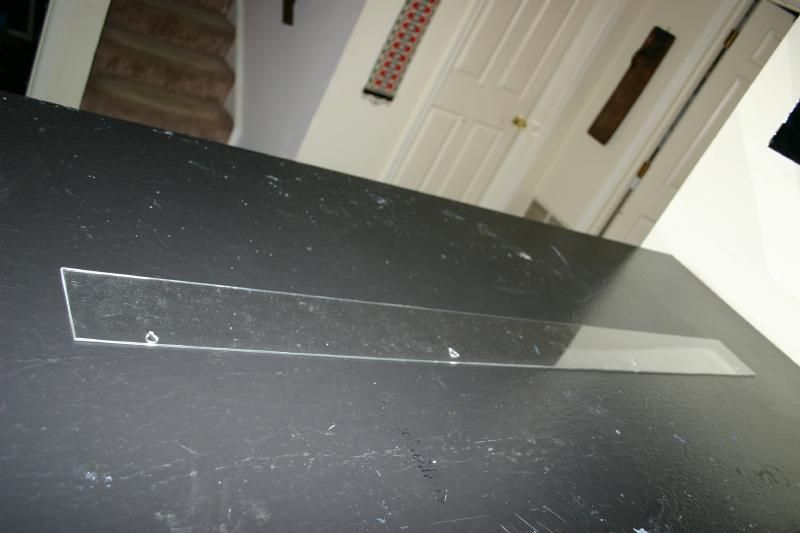

I wanted to be able to quickly hang and/or remove the plexiglas sections easily, so I drilled several slip-over holes along the bottom edge of each strip:
Here’s a close-up view:
Next, I put some drywall screws [wide head, narrow shaft] into the border area benchwork, with the head sticking out ~one-eighth of an inch. Then I slipped the plexiglas over the head thru the wide part of the hole, hanging it on the narrow part:

plexiglass will expand and contract a lot; the pro’s recommend always use slots not round holes, so don’t overtighten and watch for bow
Wow Terry, I never would’ve thought of that! I didn’t use slots in some of the staging areas where I never plan on shooting any pictures…may I better redo those?

Look for cracks near the holes; a lot depends on temperature changes. There are also special drill bits for plexiglass that cut a clean hole without melting the plastic or causing excessive stress. And if you want to bend some, just get one of those long thin 110V heater strips. Last, use only plexiglass cleaner to prevent scratches.

I checked the screw holes in my non-slit plexiglas and discovered there is plenty of ‘play’ [IOW not a super-tight fit], I just loosened the screws a tad - looks like I’m good-to-go now!
Your benchwork will move more w/ humidity changes than the plexi. Provided your layout isn’t in a Az garage w/ wild temp swings.
For a club setting where the barrier will see much abuse, we went with 1/8" lexan screwed to the facia w/ DW screws and trim washers. Thought the 1/8 was going to be too flimsy, but when visitors (children) try to pull on it it gives and only becomes a finger rest instead of a chin up bar. Lexan is much more flexable than regular plexi. The old club used plexi in 1/4", after time it developed cracks at the screws. Lexan will cut on a table saw w/ a good carbide or plywood blade. No need to do the score and snap. Home layouts don’t see this kind of abuse so plexi may be fine to use.
