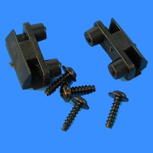

A question about motor mounts in general: The chassis on the Proto2000 GP38 has 4 holes, they seem to be spaced approximately 10mm apart horizontally. I see that the Athearn mounts, like this:
… might fit a replacement motor, not necessarily an Athearn.
If anyone has a mount like this in your parts box, could you check the spacing of “the stalks” – to see if they’re about 10mm ??

EDIT: I have some newer mounts, with screws, and they are 10mm, center to center.
LL_motor-mount-ath-OA by Edmund, on Flickr
LL_motor-mount-ath by Edmund, on Flickr
