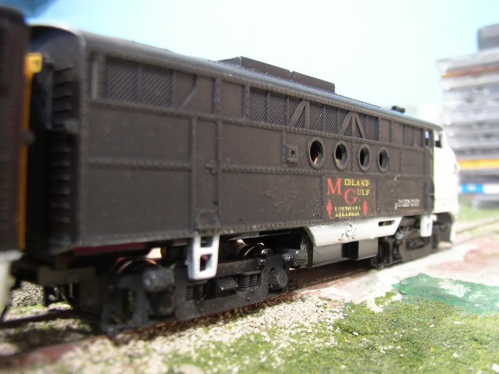

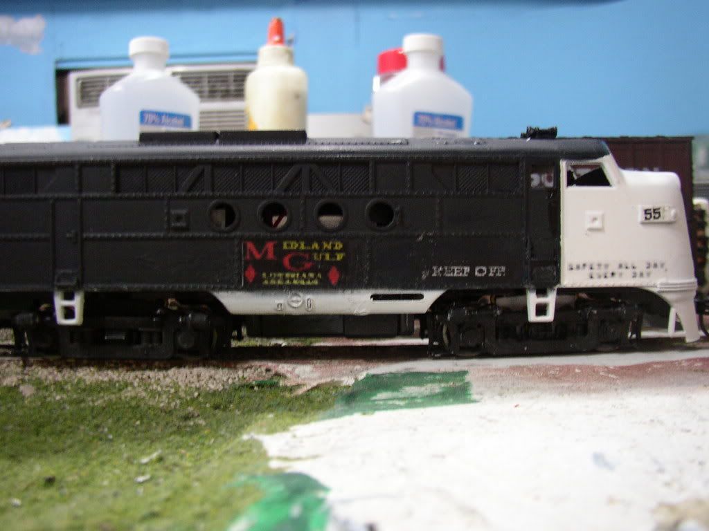

Did the work on the FT shell today. The paint on the cab is still a bit rough. I’ll take care of that tomorrow, I’m to tired to do it tonight. It wouldn’t do any harm to put the decals on though so I did that. Also did the decals for the two F7 shells. Here are some photos of the FT as it is right now.
Looks good, Jeff.

Make sure you get that pesky hair around the decal before you finish up your painting.
Thanks Tom. That hair has already been tended to.

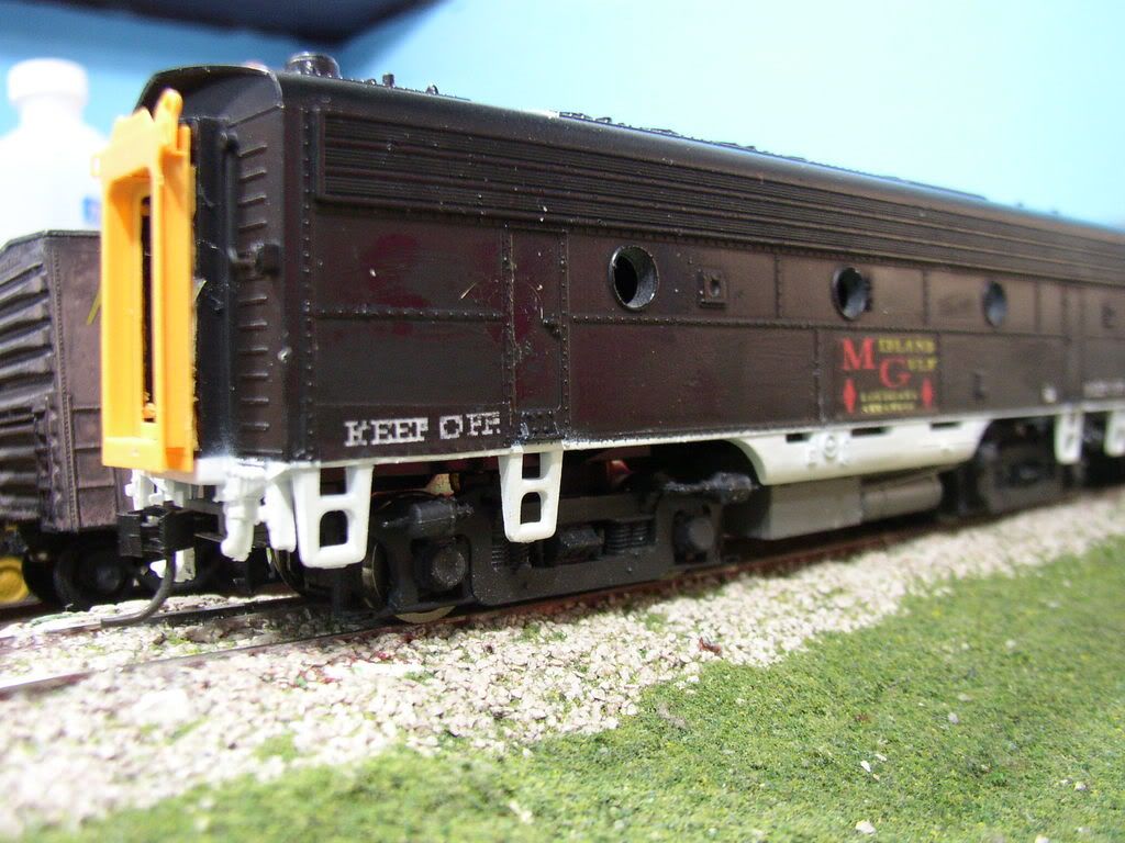

Sometimes you have to do it to get an engine running, because you can’t find the correct parts. A while back i got a box of parts and junk, including an Athearn SD-9 that was in decent shape (except the motor and drive train were missing, so made it a dummy), but it was missing a truck (metal sideframes). I dug into my parts box and found a metal sideframe truck from a SDP-40 i used to have (actually still have but it’s broken). It fit, but the siderame styles are completely diffrent. If i can find the correct truck i’ll replace it, but for now:
jw:
I have to admit, I couldn’t figure out why you did that, but it makes sense now. I used to cobble up diseasels from train show box lots. It was a cheap way to get something with a coupler on the back that could haul trains. [:)] Your workmanship is better than mine was then, however.

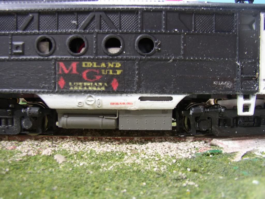

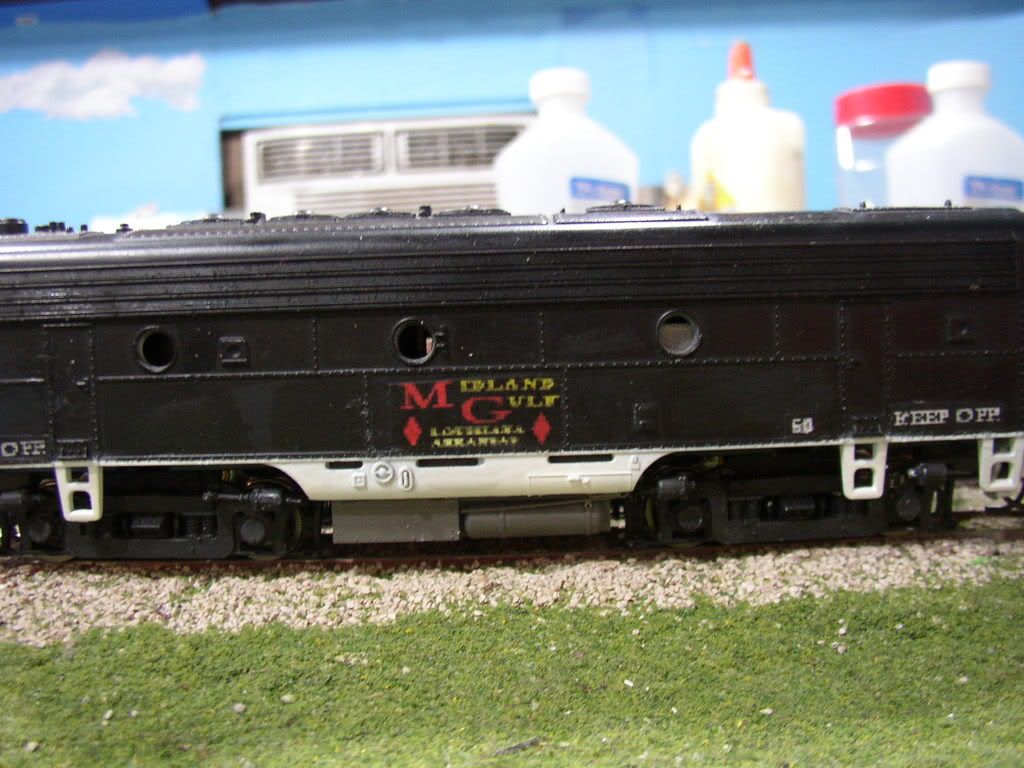

The FT is as done as it’s gonna get and the F7-B needs just a spot of paint on the diaphrams. Wish the decals were better but this new printer is a piece of crap!
Looks great Jeff.
I licked the decal printing problem. By making the decal at a larger font size, say 12 instead of 6, and printing it with printers scaling set at 25% I get nice crisp decals with no blurring or fading.
