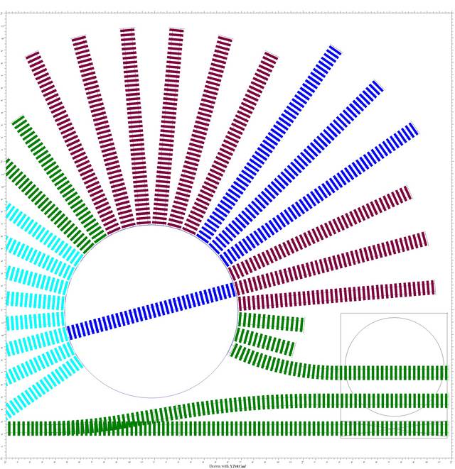

Here’s a pic of the diorama:
It’s a little off, as the table itself is closer to 40" on each side, but the general design is still the same.
Dark Blue tracks are a 3-stall RH
Rust tracks are outside storage (parts cars, wreck train, etc)
Green tracks on the lower right (and along the bottom) connect to the “rest of the yard”
Teal/ Blue-green tracks may ormay not exist, they’dbe the TT lead(s) or tracks going off “to the backshop” or something.
The line drawing in the lower right MAY be where I put a coaling tower, though the trackage there is still slightly up in the air (I’m not entirely sure I like it as-is, might get reworked to be a good place for photos or something)
