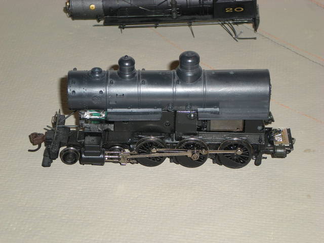

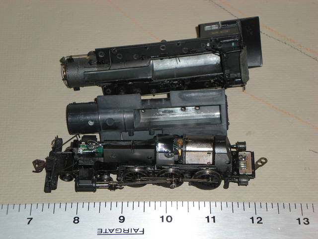

Here is a picture of the Spectrum 4-6-0 frame, the Roundhouse boiler and the Spectrum boiler. Note the split frame of the frame which goes all the way to the front of the boiler. Note that the Roundhouse boiler is SOLID in that area.
Here is the Roundhouse boiler sitting on the Spectrum frame. I have lined up the smokestack with the cylinders. Nother the roundhouse boiler is shorter than the Spectrum engine so the “stretch” can be hidden in the cab.

Thanks Dave,
That is very useful information and looks as if I could pull it off. I have been a modeler of sorts for years and have kitbash all sort of model cars so I think I can at least attempt what your showing. Now here is the next question. Can a person pick up a round house boiler with out buying the locomotive say straight from roundhouse, I know I can get Walthers parts for their equipment and would assume I can buy a boiler from them. Looks as if a new Spectrum locomotive is in my future I see you can pick them up on Ebay reasonably priced at least under the $175 list price.
