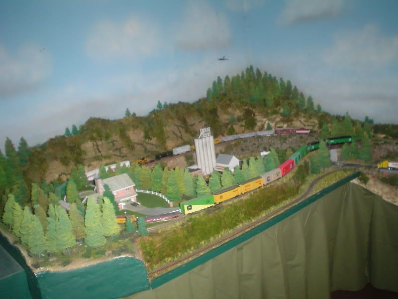

Here is my first time I pulled the whole coal train.

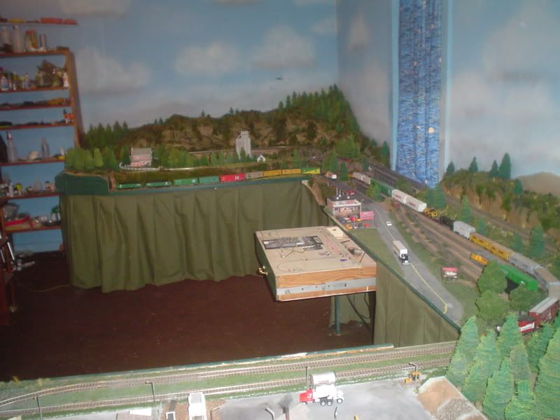

Okay Art here is the best I could.
I told you all wrong, there are only 25 cars, there would be 30 if I had them. Still proud of them girls. Mike

That is impressive. First time I have seen the layout as a whole. I really like the ideas and the artistry. Thanks.
Well Thank You Art. That makes me feel good. I spent a good part of the day today putting in 21 more street lights, and still want another 25 or so. Mike

Thanks for your help. I’ll also compliment Mike and Art on their work. This is the first time I’ve seen wide shots of either of your layouts, and they are really inspiring. Thanks for the wonderful images.
I like the plane above the layout. Nice touch. And looks like you have definately made the MOST of your space. I am about to build a layout in a fairly limited space, and seeing things like this makes me confident that I will be able to do a lot with not much space.
