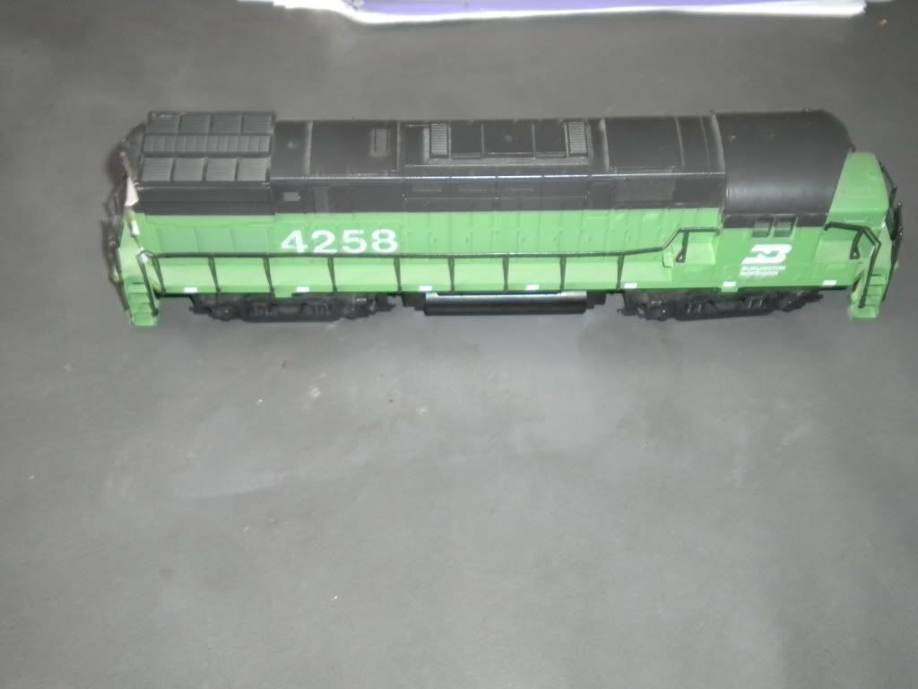

If you have the locomotive shown below, an Alco C-425 that was released by Atlas (Yellow Box) than the conversion guide at Kadee.com shows you should use a Kadee #5, or # 148 which are categorized as medium center set couplers. If the locomotive has been damaged over the years or is from another manufacturer posting some pictures for possible solutions or checking the conversion guide at www.kadee.com should help you.

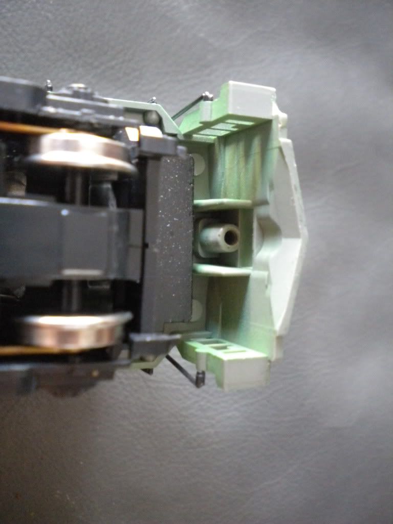

Thank you all for your help. It has been great. The locomotive is made by Kato which is a company in Japan I guess. I took a few photos and now cant figure out how to post them. If you buy the coupler from kadee do they send you the little screw as well?

What you have is an Atlas locomotive produced by Kato. It will be listed by the Atlas name not Kato. The locomotive is an Alco C424 or 425 marketed by Atlas and made by Kato. If you look it up on the Kadee site as an Atlas Alco C-424 you should find that it will take a #5 or # 148. The #5 has a separate centering spring, the #148 has integral “whisker” springs that eliminate the need for the separate spring, I recommend #148 rather than the #5 for that reason. Either will slide right into the opening in their draft gear box. The Atlas locos of that time came with a black friction pin to secure the coupler box in the opening (sorta looks like a phillips screw but without threads), this can be replaced with a 2/56 screw, available at you hobby shop or a Radio Shack.
