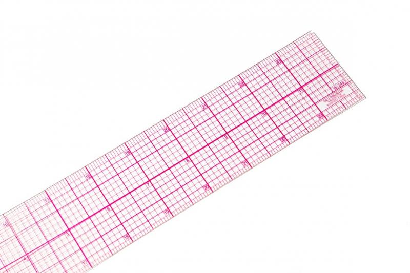

I found a really good aid for aligning decals:
It’s a C-Thru ruler–VERY handy for lining things up.
