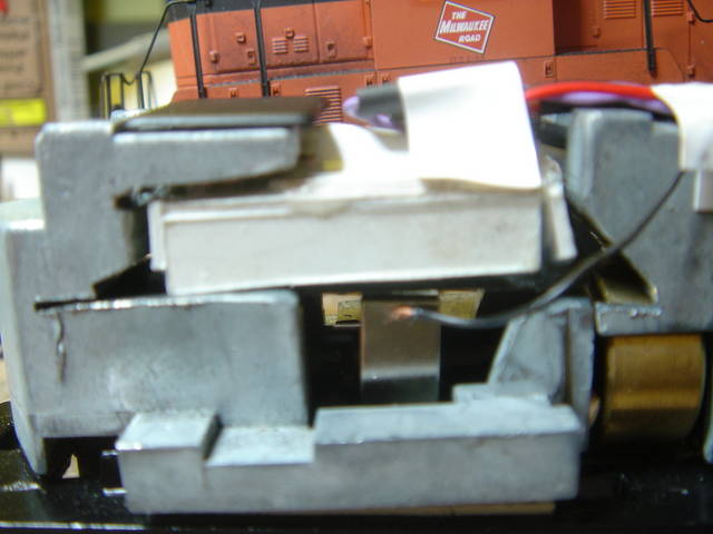

I put a Tsunami in this Proto GP9:
The Tsunami is the lavender thing on top. I made my own speaker baffle, which sits over the wheels on the left:
There was significant metal-cutting required to fit this in. I had to cut down the weight under the Tsunami, and remove material for the speaker as well. On the other hand, the engine sounds and runs just great now. It was my first Tsunami, and I’ve since bought several more.
