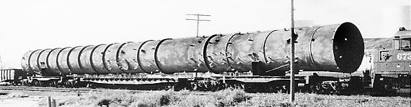

And lest I start a new question, an idler flat car is not a special kind of a flat car. It is just any suitable flat car operated empty as a “spacer”. Here for instance is an idler flat car operating in between two heavy duty flatcars which are bearing the weight of a looooooooooooooooooooooong oversize load.
