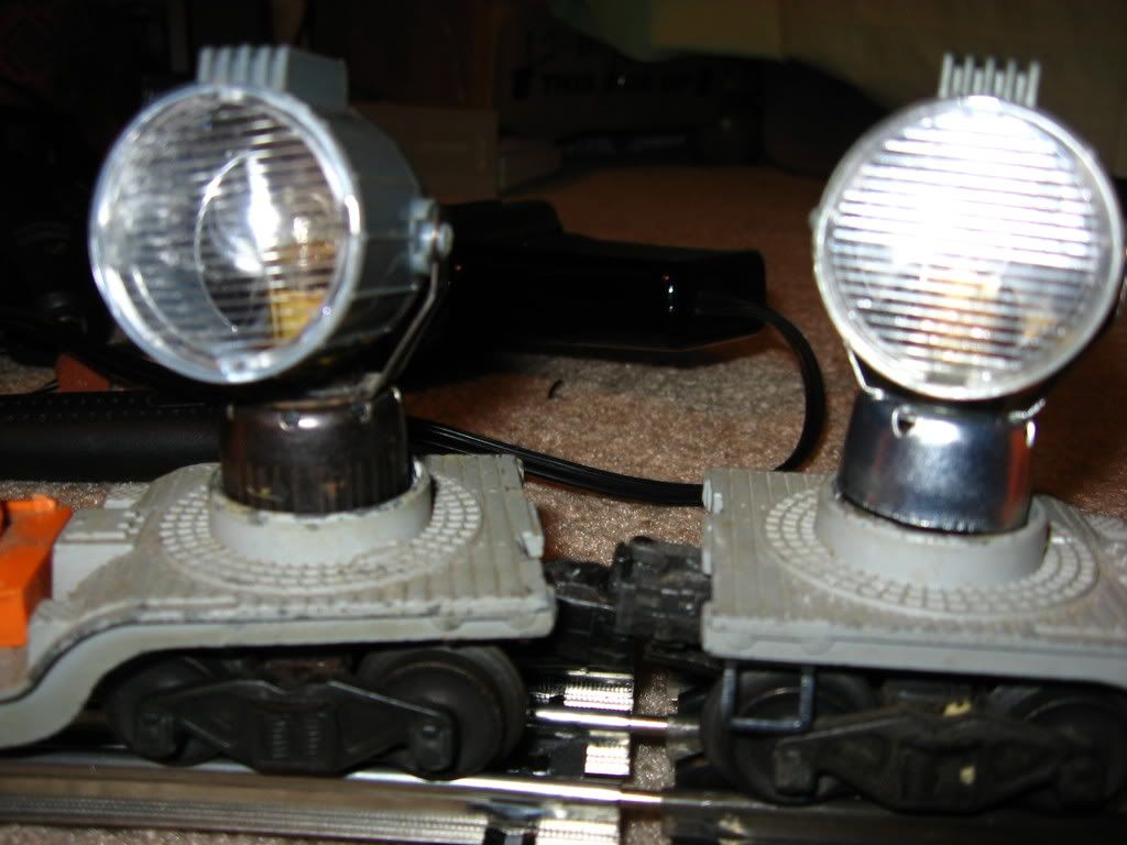

Here are some photos showing what I’m talking about.
The junk-bin car is on the left, the good one is on the right. Notice the gap between the base of the bracket and the car on the car on the left.

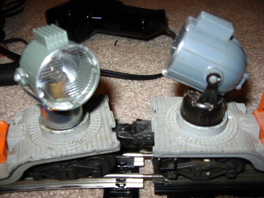

Here are the brackets switched between the two cars-notice that the original bracket still sits properly and the replacement still sits uneven.

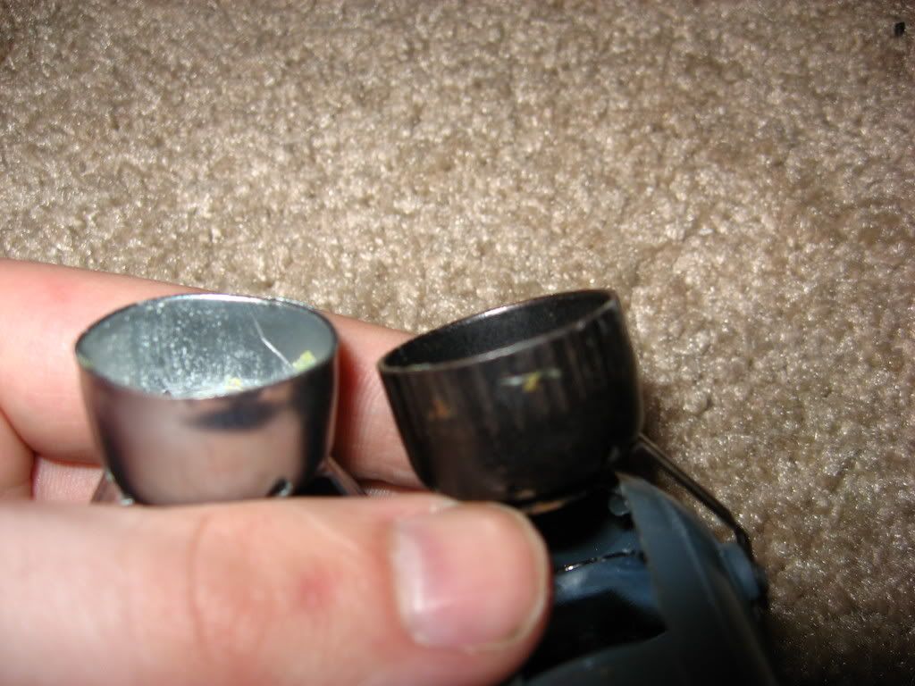

Finally, here’s a comparison of the bottoms of the two brackets. It’s a bit hard to see, however if you look carefully, you can see what I’m talking about with the wavy bottom of the replacement bracket.

Perhaps you could grind the base of the housing so it’s truly flat. Other than that there’s ebay, but I’m sure this part would cost way more than the car.

That bracket is definitely a repro. On these reproes, the metal used for the bell housing is thinner than the metal Lionel used. Do you have a Dremel tool? If so, use it to even out the bottom of the bell housing. You can also use a flat file to do this by hand.
