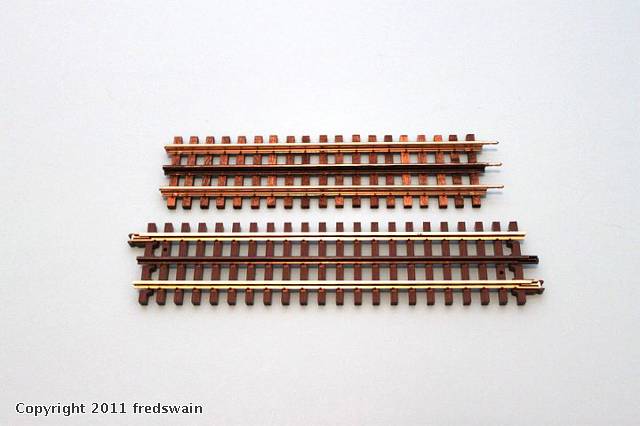

A neat thing about tubular track is that it is also the poor mans hand layed track. I bought a bunch of scale sized ties, removed the tubular rails from the standard metal ties completely, and glued and spiked them down to these scale sized ties. I had prestained the ties. When finished I blackened the center rail. This is a very cheap way to do it and far cheaper than buying new track. I call this the poor man’s 21st century track system. Here’s a finished O-27 straight next to an Atlas straight.
http://www.photos.jcstudiosinc.com/user319/o27.jpg
