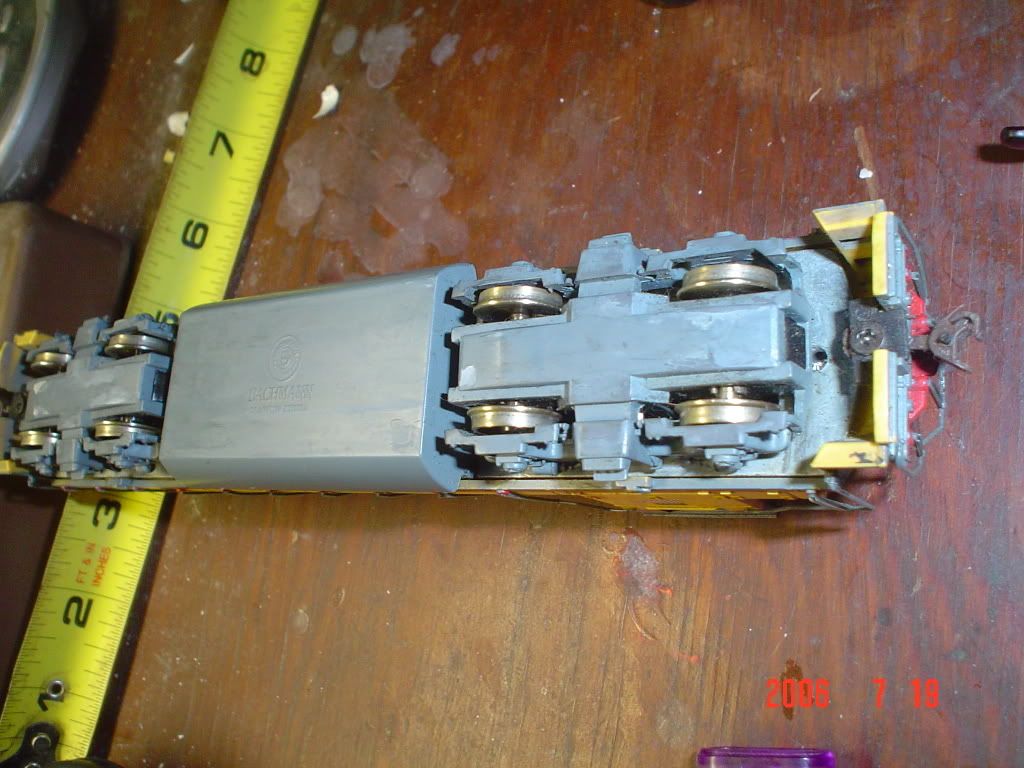

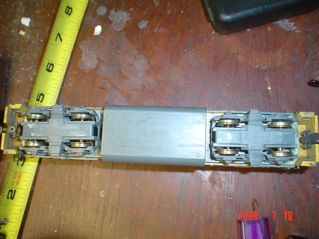

Here a a couple of pics of the underside of the Bachmann, You can see how the NS has been polished off. I wish I was rich instead of so good-lookin (HAHA) I would buy a fleet of Atlas locos.
