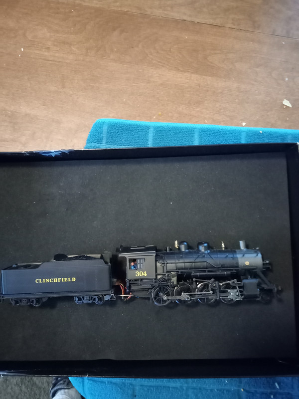

I was running my Clinchfield #11422 Bachmann Spectrum 2-8-0 and it seems to run quite slowly even with my Control Master ll at full throttle.I wonder if it has low gearing or if something is wrong with it?

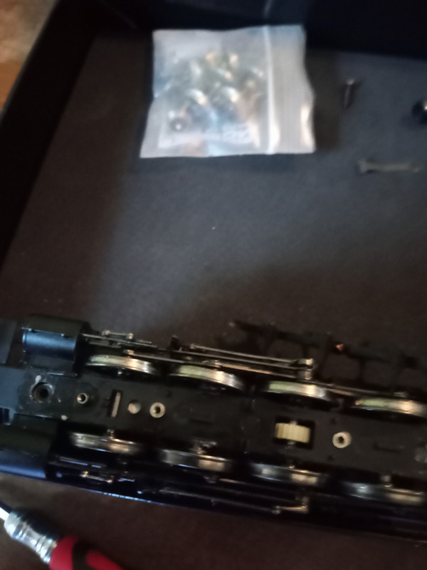

Ok I think I found the issue and it is fairly serious,the second set of driver’s looks bent ,I guess they will have to be replaced if I can find them!
I have no experience with Bachmann steamers, but it looks to me (from your pic) that the 2nd set of drivers is “mis-aligned” in the frame. Note on the left, it looks like a bearing (or something along that line) is visible (not visible on the other drivers).
I’m thinking the problem might be more apparent if you removed the screws on the bottom plate and lifted it off for inspection (again, not sure how these things are disassembled)…

Removing the two screws on the bottom plate should be all you need to do to remove the plate and see inside. Be sure to have it upside down in a foam cradle or something similar. As suggested it may just be that one driver wasn’t installed properly, and just needs to be put back where it should be.
Even if bent you can rebend them, did that once. Looking at blow up of pic it sure looks like it was misaligned in the begining.
It’s not unusual for Bachmann engines to have a hitch because one of the siderods is hitting, and bending it a tiny bit solves the problem. In this case, it looks like one driver just wasn’t installed properly. If that’s all it is, it should be easy to put right.

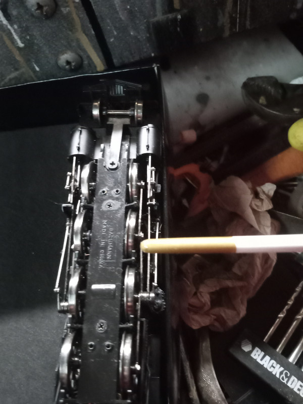

Ok I took off the bottom plate and tried to straighten the errant driver set.Nitvmuch improvement but it runs better and faster in reverse so it may be a bent drive rod.
In the pic it certainly appears the driver axle must be bent, this could be causing trouble with the siderods hitting.
If it’s under warranty, I would try contacting Bachmann. Otherwise, you can buy a replacement, but unfortunately you have to buy a full set of four.
