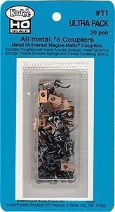

Thanks all tor the help. I will order some couplers and was wondering if these are the right ones?
I am going to get enough to do my rolling stock as the others fail. Thanks Mike
Thats them…
Just to add , [2c] instead of #5’s , I’ve been buying and using the new #148 whiskers, same coupler except improved, if you can imagine that. The whiskers really work nice.
THE ONLY WAY I see the #148 as an “improvement” is by a simplified ’ centering spring that gives up KD’s patented ‘Delayed Uncoupling’, - a benefit for those fnding the #5 ‘flat spring’ too technical.
The #5 and #40 series centering springs use two different tensions on the coupler heel - if one looks closely - which is why it works.
