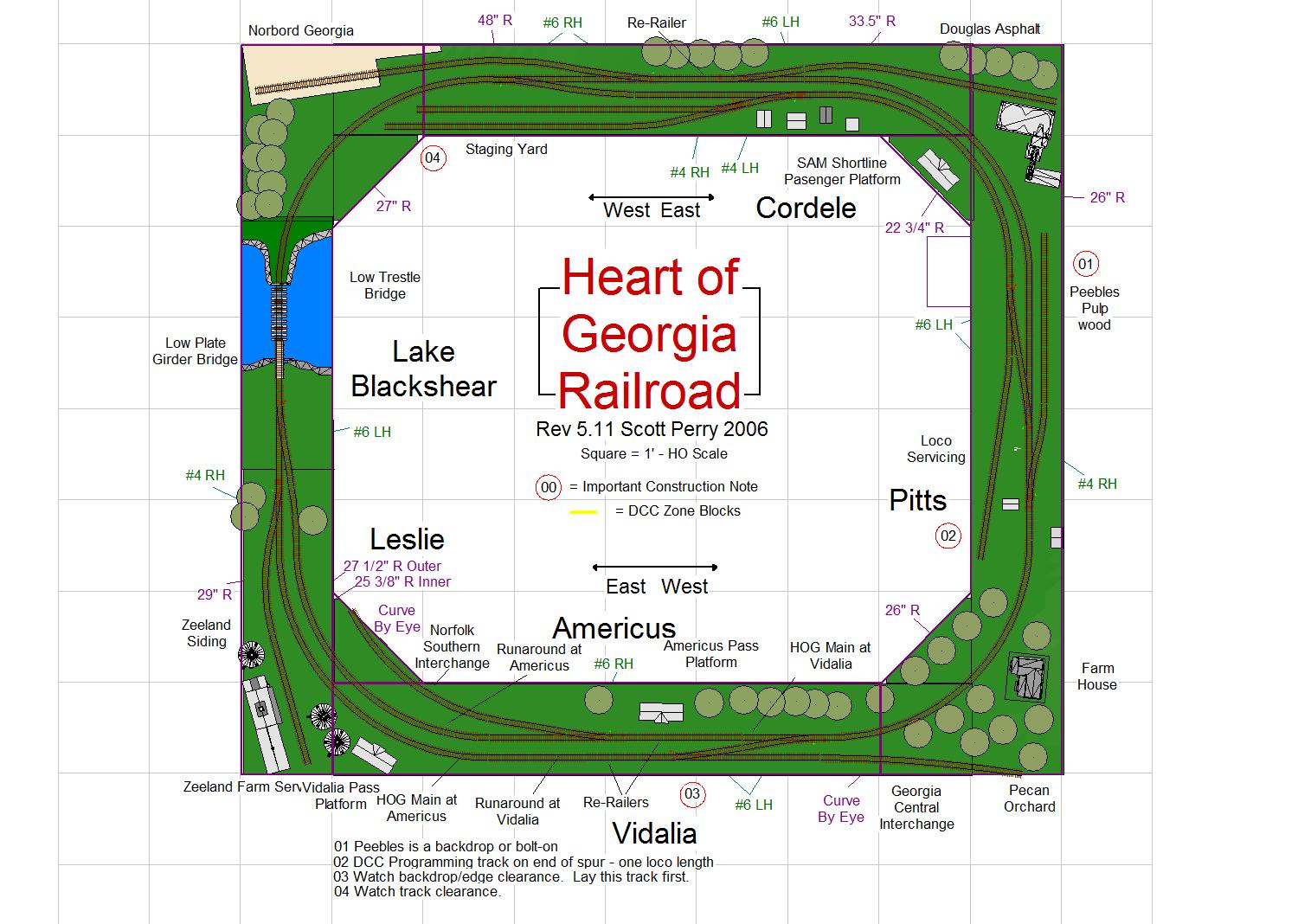

Is this a decent layout?
It is 8´ by 8´, but can easily be extended by 2´. A joy to build and fun to operate.
