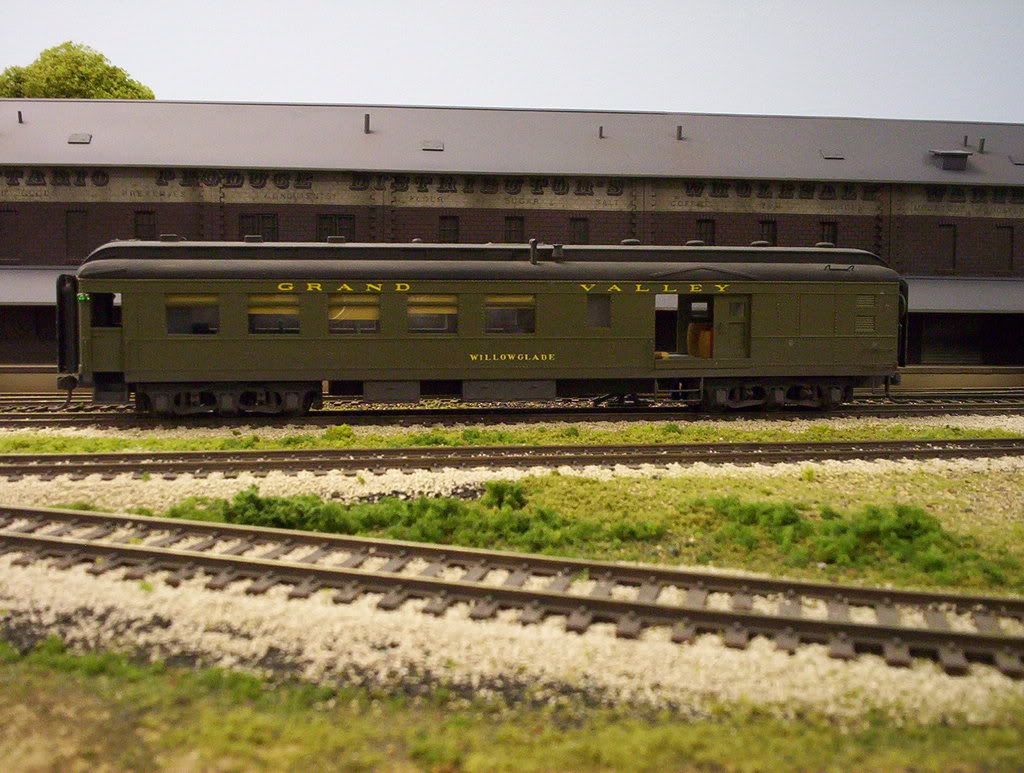

The heavyweights are what I have now, and I got a lot of enjoyment detailing them:
They can also be made into pretty-decent wood-sided baggage cars…
…while the diner, shortened, makes a nice combine…
…and the Rivarossi combine works well as a doodlebug:
