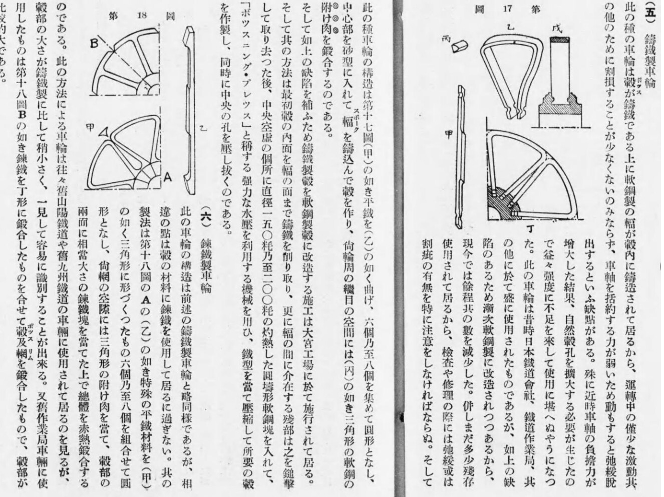

An enthusiast informed me that the two types of split spoked wheel structures are explained in a book held at the National Diet Library of Japan. It’s in “Passenger and Freight Car Stories” by Okubo Torakazu, published in 1925.
The book not only describes the manufacturing method but also the reinforcement method. At the time, railways had transitioned to one-piece wheels, but it seems that old wheels were still being used carefully.
