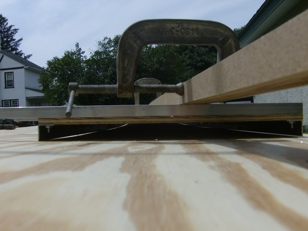

Here is the first progress update. The benchwork for the first section is now done. It is aluminum angle and channel with 1/4" Ply inbetween. The bench is really light but still rigid so it should result in a good portable section. I temporarily clamped the spline together with a few C-clamps. For now it is resting on the channels but will be elevated a few inches on risers. Here is a pic.
This pic shows the structure of the benchwork better. It is similar to L-girder. There are two angles running the length of the section with channels as joists. The plywood works as a diagonal brace.
