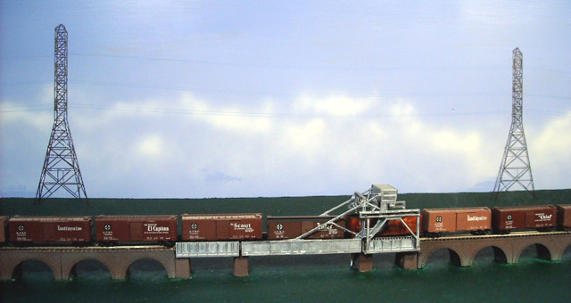

When driving along the bayfront with a clear view 200 degree plus around, I noticed some particular about cloud perspective. Straight overhead, they are big and smaller when they are far away and near the horizon. But also, as the view approaches the horizon, one is looking more “flat” across the underside of the plane of clouds. They tend visually to clump all close together in front of each other, like a telephote picture of telephone poles that look that they are placed 2 feet apart when looked at “endwise.”
I tried to capture this cloud perspective on my background, with looks of small cloud “structure” all running together into a haze near the horizon, and getting bigger and more inhdividual higher on the BG.

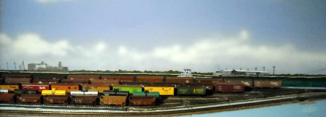

I am not as satisfied with this one:
All clouds are from “rattle-can.”
Now, those are lookin’ like real clouds. [tup]
