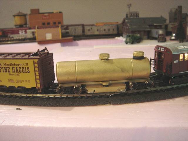

This is a shot of the car, on an un-scenicked part of my layout. I put it between a reefer and a subway car to show the size:
The car is a brass tank which holds your choice of cleaning fluid. They recommend lacquer thinner as an “aggressive” cleaner, or alcohol as a “second tier” cleaner. I use alcohol in mine, because it’s winter and I didn’t want to offend the ladies of the house by using smelly stuff while the windows are shut. In the picture, the knob at the right side of the car is the fill spout for the fluid. The knob in the center controls a precision needle valve which sets the flow rate for the fluid on to the pad at the bottom, which rubs on the tracks.
Subways imply tunnels, and that’s what I’ve got. I bought this car because I have to keep the tracks clean in my tunnels, and that’s a chore to do by hand - more-or-less impossible in some spots.
This is a very heavy car, and the friction from the pad on the tracks makes it even worse. I need to MU together two subway power units to drag it around. (My road engines won’t fit in the low-clearance subway tunnels.)
It really does the job.
