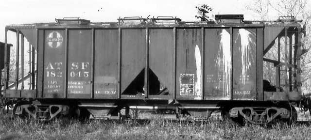

Here is a real Santa Fe covered hopper, ATSF#182045, Santa Fe class GA-52
at Glen Flora,TX 1981

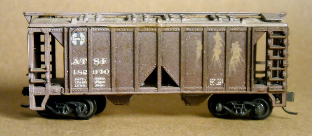

I researched that car, and used it as a basis to paint and letter a V-Line kit.
