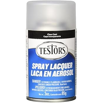

Thank you everyone! I would have posted sooner but I didn’t receive any notifications (I guess that feature isn’t working). The "rumor’ I alluded to seemed real enough as Amazon and Ebay were selling Dullcote at crazy prices and the local stores here were all sold out. Maybe it is a temporary thing.
I will continue to use it, but am interested in the Tamiya product too. Having a back-up plan is a good idea.
Michaels llists the same Testors product. It’s cheaper than Amazon. I use it.
What Testors did was remove the word DullCote from the package. That threw me for a loop for a while too. But I saw that the words DullCote are used in tiny letters on a wee bit of paper label that keeps the lid on the can body. Seems odd that Testors spent all those years creating such brand recognition for DullCote and now they seem embarassed by the name. But it isn’t the only strange decision Rustoleum has made since acquiring the Testors name and assets.
DullCote did seem to change their forumla some years ago. Something to do with the talc suspended in the transparent medium?
At any rate, any time Michael’s crafts has their 50% off any one time coupon in the paper, I head over and more often than not I use it on a can of DullCote.
