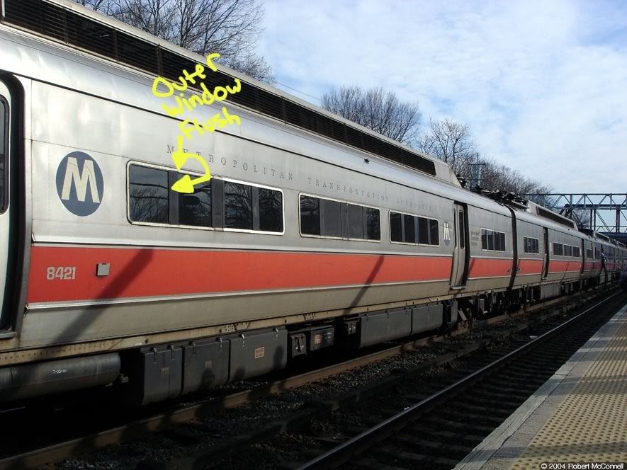

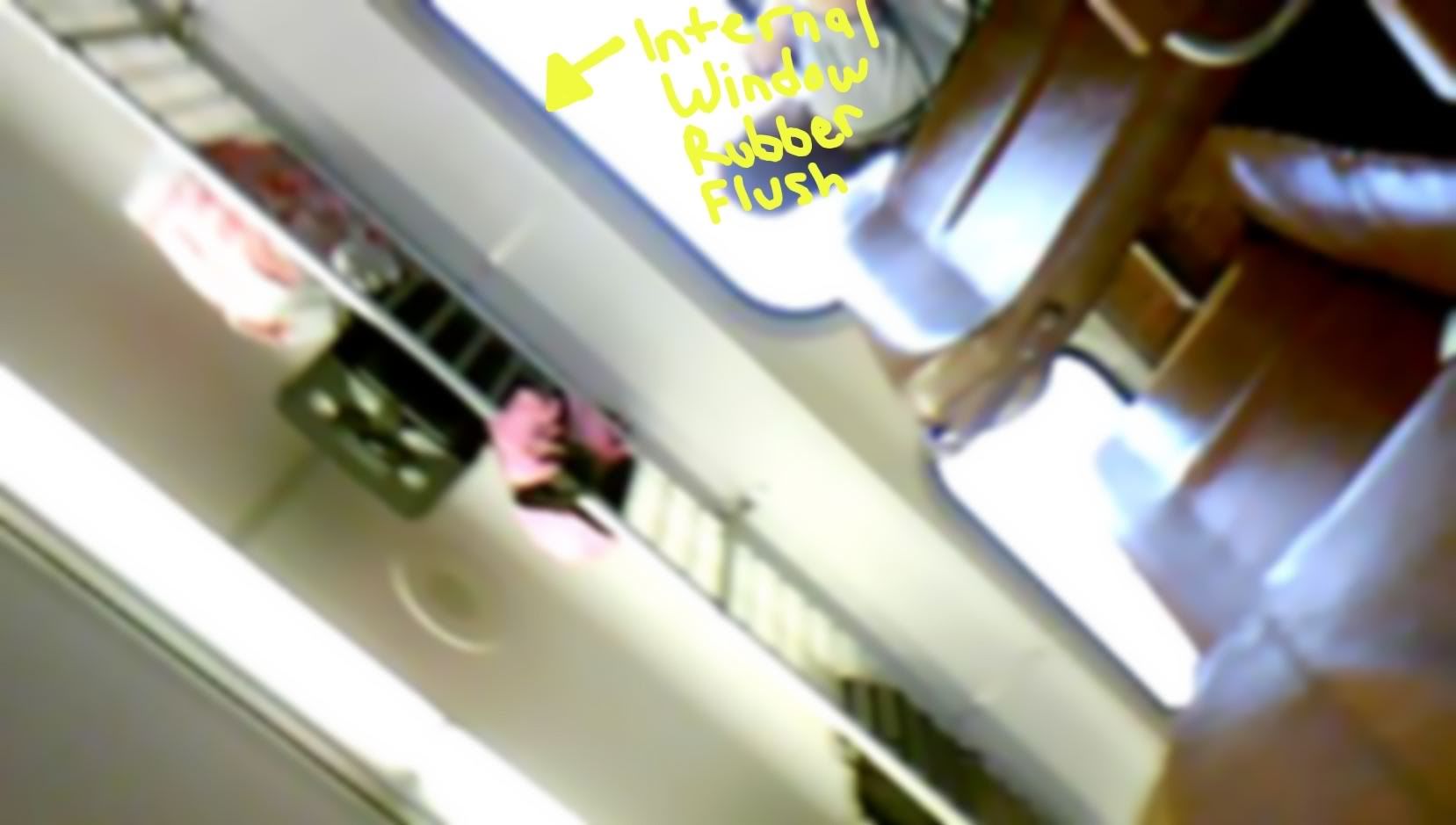

Where can I obtain detail parts for windows? I want to personally add an extra rim or rubber/flush for the GE Jersey Arrow/LIRR M-1 car shell windows, both inside and outside. The reason why I want this is because I have finished deflashing the shell using an X-Acto knife. Not all the windows have a razor sharp finish due to deflashing. If I insert flushes for both inside and outside of the coach shells the will look professional. I have attatched a picture for a visual illustration description.

What you want is not made to the best of my knowledge. The only way I can think of to model the rubber seal is with black paint.
I have heard of folks using a fine point, black Sharpie to color the window gaskets/seals. I tried it myself once (and plan on using that method again), and it works fairly well. You just have to be really careful to take your time and have a steady hand.
If you do use a Sharpie, don’t paint over it with clear lacquer like Gloss Coat or Dull Coat. It will make the ink run. Ask me how I know. [#oops]
If you are working in HO or larger, you might try striping tape. The tape people use for making the track lines on control panels. The R/C airplane hobby people have a striping tape that is really narrow for simulating aircraft access panel lines. That may work.

Rather than a Sharpie, go to a graphic arts or artist supply house. They have special VERY fine markers used for drafting etc - half or less the line thickness of a sharpie. My [2c]
