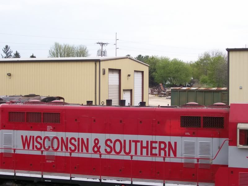

How would I know wheher a Geep has been re-engined from external evidence?
I have seen a pic of a GP9 without dynamic brakes which appears to have four exhaust stacks. Would this be a Cat engine? What happens when there are dynaimic brakes?

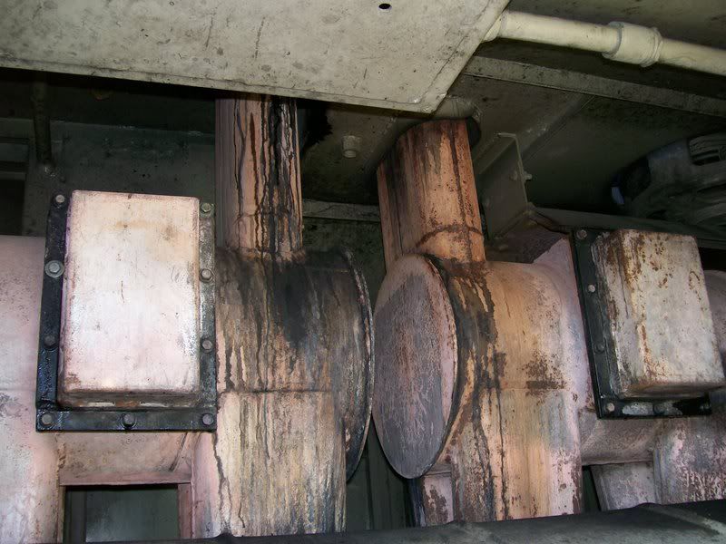

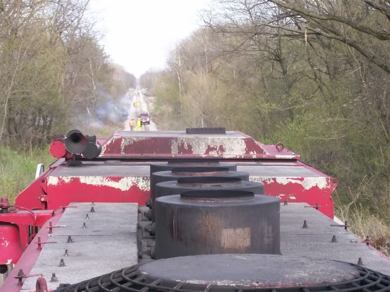

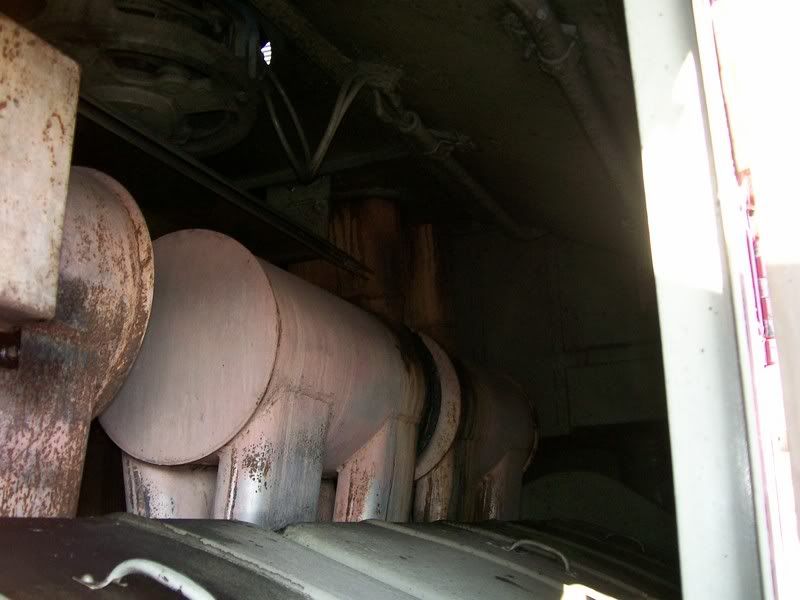

Most of the geeps with CAT engines that I have seen pictures of seem to have only 1 stack usually mounted towards the front. The engines with 4 stacks are ones that have had the exhaust manifolds change to allow the gasses to flow easier, sort of like performance headers on a car.

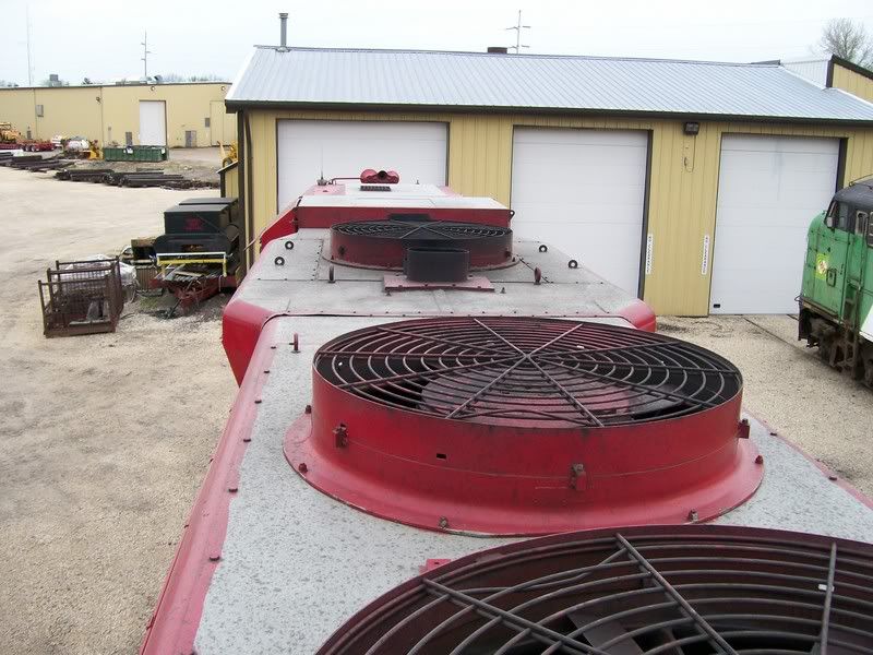

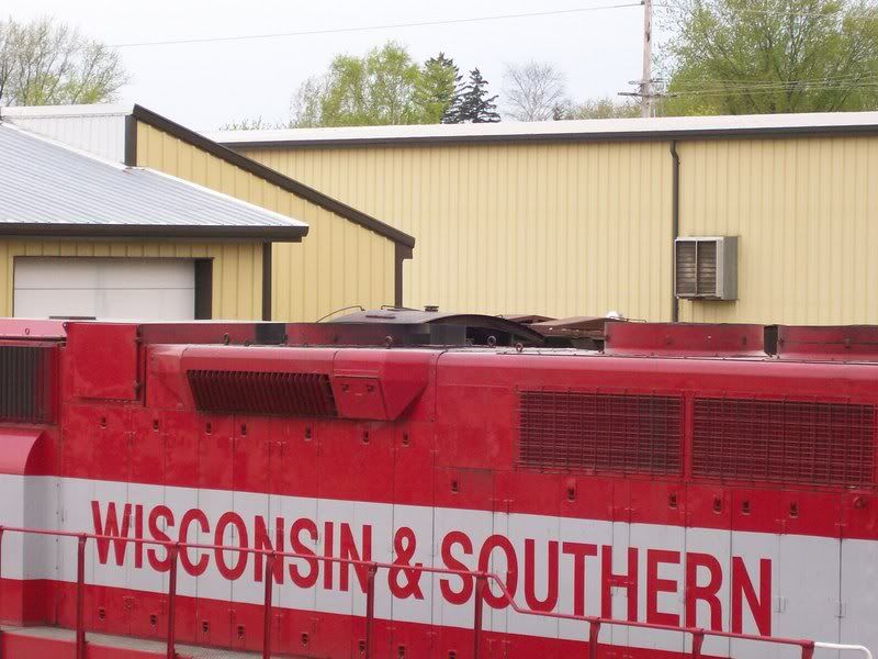

With dynos, just cut a hole closer to the fan, and run the stack up.
And from on top.
With out dynamics, it is a little easier.
Could need 4 spark arrestors.
Cat engines usually have just one stack, and no spark arrestor. Not many Cat engined locos around.
4 exhaust stacks are a common modification, especially for those units without dynamics. Virtually all the MP GP7/9/18’s (and some GP38-2’s) had 4 exhaust stacks. Reduces backpressure in the exhaust manifold.
CAT engines usually have a smaller single exhaust stack.
