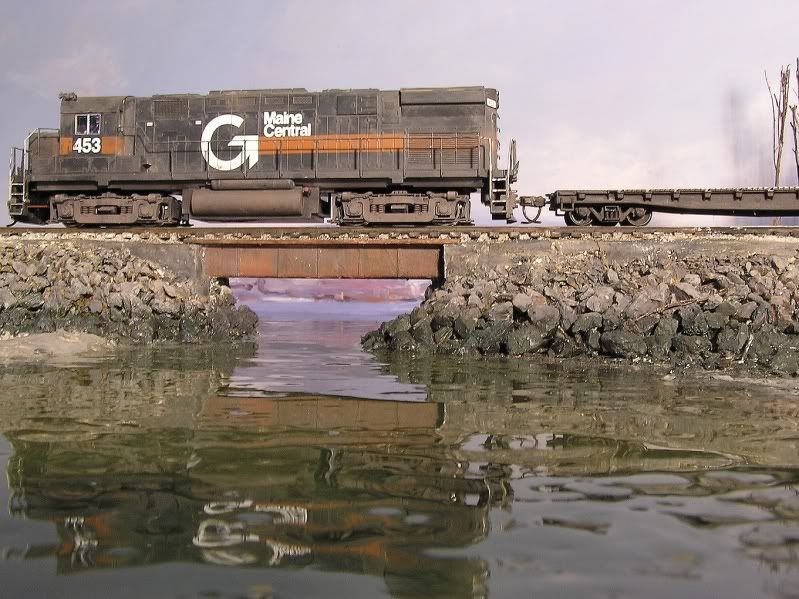

I finally got the photos to come through. I guess I haven’t been using my photobucket account enough.[(-D][(-D][(-D]
Sue

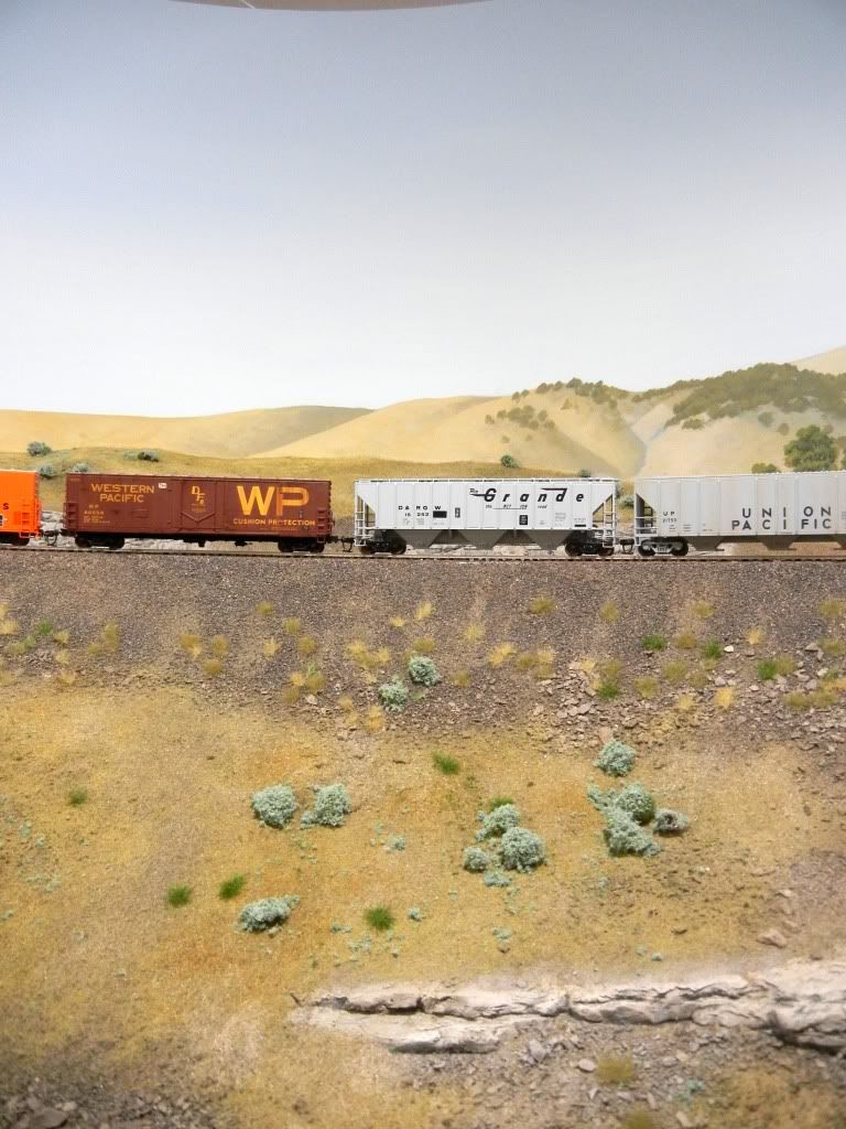

Real rock is of limited use for cliffs and such. In addition to weight, there’s the problem of integrating the rock so it looks appropriate with adjacent scenic shapes and textures. More often than not, when I’ve seen real rocks used for this purpose they don’t look good at all.
Rock as ground texture and talus is another matter, and I make extensive use of it. The exact color doesn’t matter, as it can easily be dry-brushed to match the color of the surrounding scenery.
Above you can see real rock used for talus and to build up the fill below the track. The rock color didn’t match the plaster cliffs exactly, but some dry-brushing eliminated any difference.

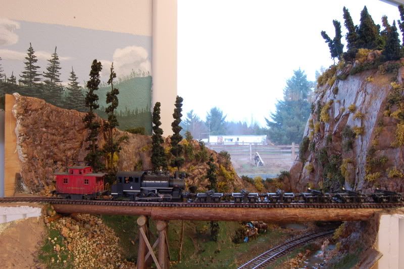

The process was similar above. The fill is built up from layers of dirt and rock, as is the talus material. There is a layer of natural sand below all of the ground cover to prevent seeing plaster texture through the grass. Again, the cliff face is plaster, and colors are adjusted by dry-brushing.
