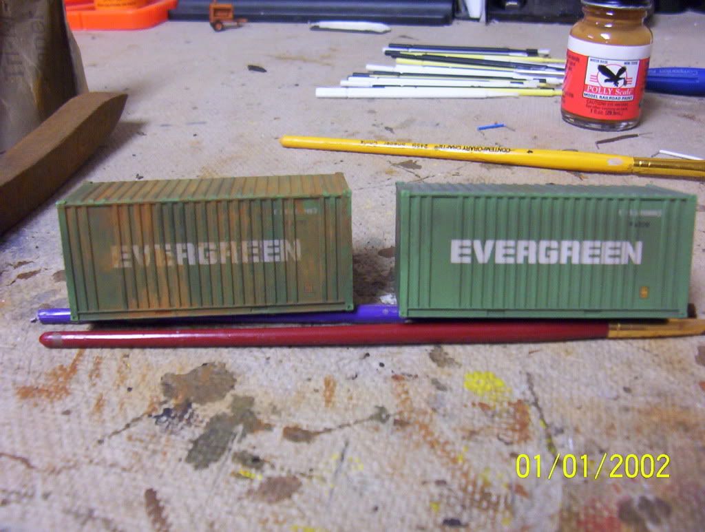

Well i was looking for a new way to simulate rust on freight cars and anything i would need rust for. and i found out that you take sandpaper and sand rust off off metal and use the fine powder and brush it on anything. I tried it, and it looks awesome, sorry if they’re not too clear:
new and old

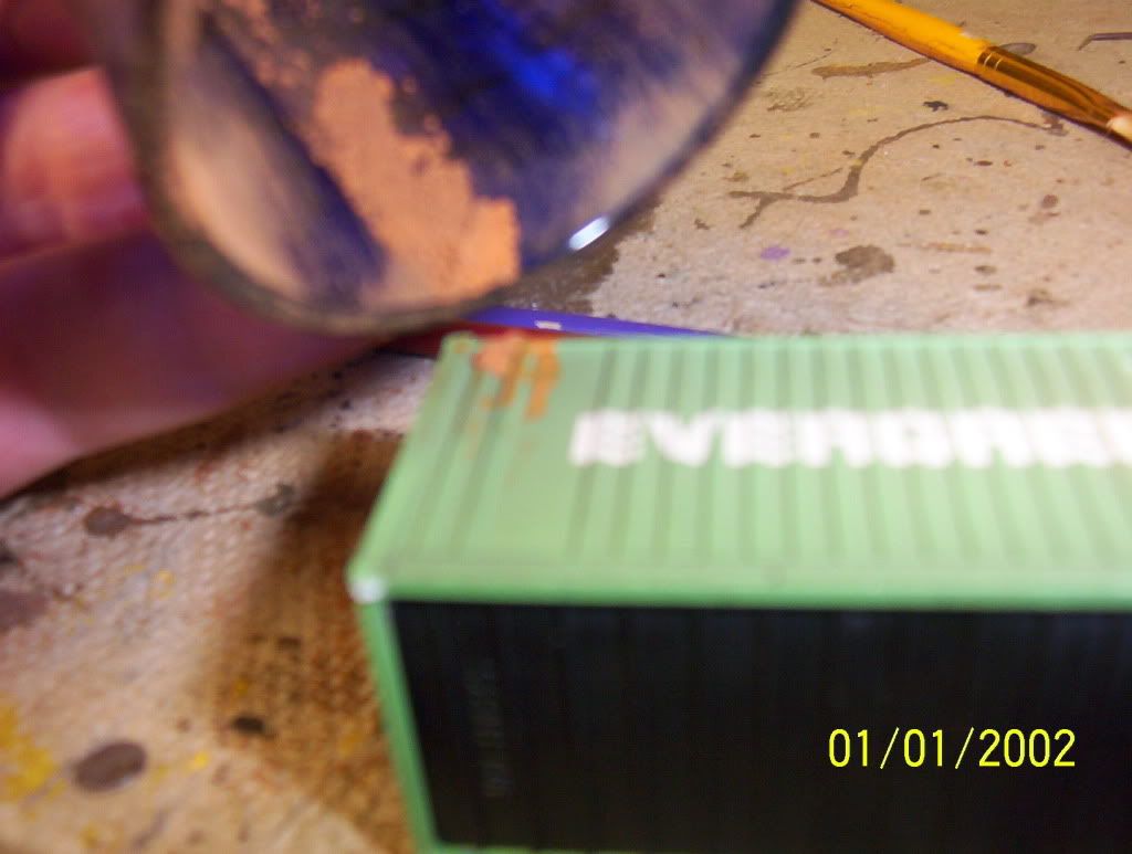

metal sheet i sand
then i paint on an adhesive, in this case polly scale rust

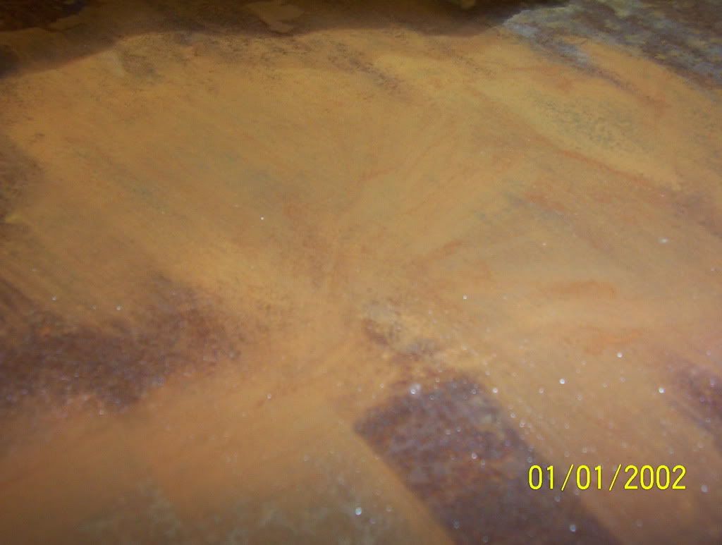

then i dump some of the rust powder on the wet paint

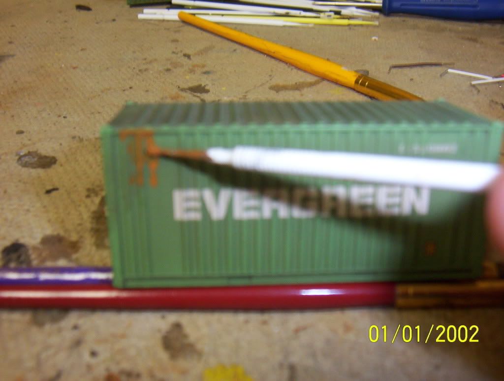

then i work the powder across all the paint and dump the excess back into the cup

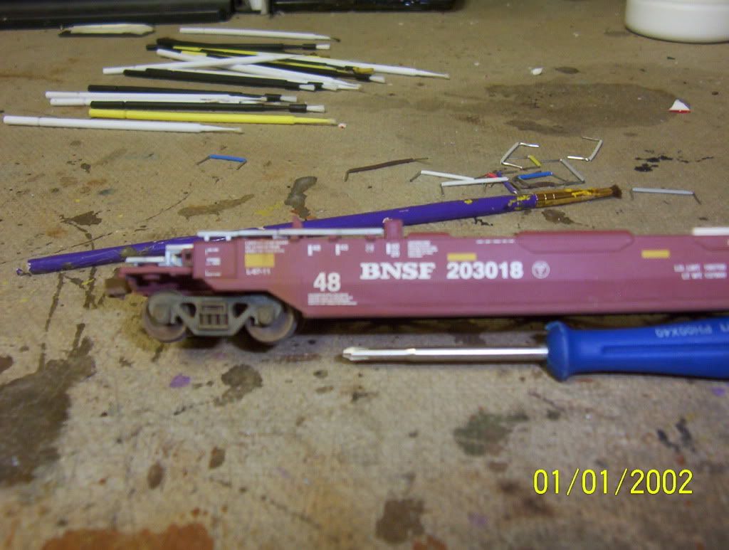

also used it on these trucks
It even smells like the real thing too!! haha just kidding. Ya it works on anything and its free except whatever you buy to glue it down, oh yea i recomend using clear coat cuz it doesn’t stay too well even with the paint. also its cool use because most rust is similiar in color and you can get different shades of it by how much you use and what color of paint you use underneath of it. i’m still experimenting techniques with it, but tell me what you think, and any tips or ideas for the use of the rust would be cool also. thanks

ya i didn’t think about that but i dont put it on the axles or behind the wheels
