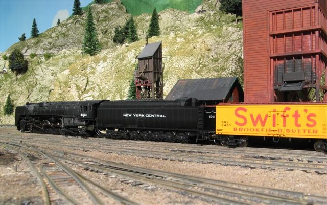

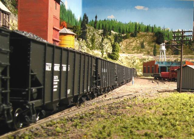

Selector - is that from your layout? I’m going to be building a similar scene on my layout… thats the perfect example. I want to see more from that layout! haha

Okay, one more image, but that’s all 'cuz it’s Stein’s thread. I am glad you like it. [:)]
