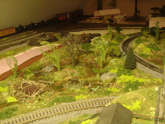

I started with this as the site of a modern high-tech swamp:
I used a utility knife, cutting the flat surface about a half-inch deep in a grid about a half-inch per square, and then I dug it out with a knife and a spoon.
That’s really about all the depth you need. The difference between a shallow swamp, a pond, a river and a deep harbor is all done with paint. Darker paint makes the water look deep, and light paint makes it look shallow.
Yes, I really used a spoon.
