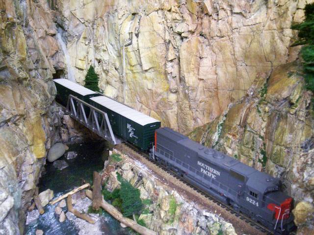

Bob, perhaps your not familure with this techniqe and it was new to me, found using Bragdons Geodesic scenery and it also works on plaster after it is painted with Gesso, Gesso indoors and Kilz outdoors.
Gesso is what artists apply prepping thier canvas to accept the best color.The gesso actualy elauminates a bit thru the washes, weird but effective, my picture is not correct, it looks better and no Im not bragging, its just the way it is…
While applying gesso watch those cracks and pull paint out of detail areas, then let dry.,
For highlight black tempra is dabbed and brushed into the cracks and crevices, wet water misted, and wiped of with a sponge, leaving a very light greyish tint on the rock body, dont wash out the tampura in the crevices., let the black in the crevices dry. .
Then very light washes are applied in a camo pattern, then overlayed with more washes untill the effect is desired. The Key is trasparent washes as this method is not to stain in only a few coats.
Note the back wall of the canyon above. The sides are a tad darker compaired to the back (center) gives the impression of depth, gave more washes to the side.
I have tried the black washes on plaster, what I enjoy with the Bragadon method is that one doesnt over paint it, but if one does is easy to correct as Ukguy stated above.
