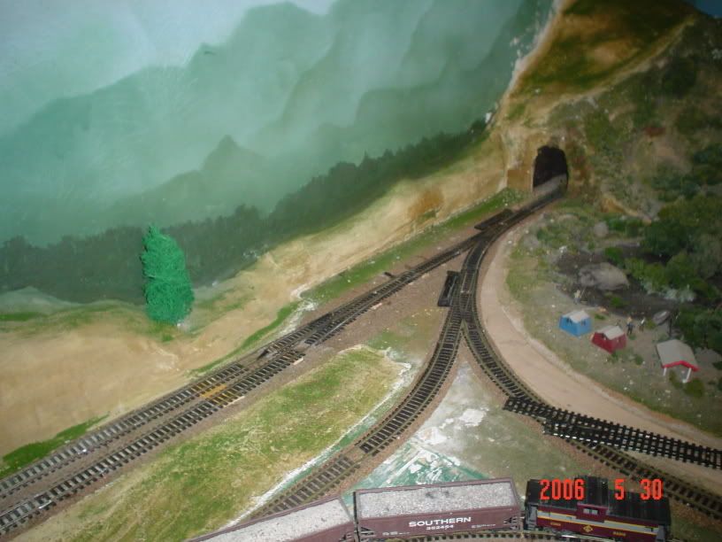

Something I forgot to mention is that the turnout is on the end of a reversing loop, thus only one end is soldered. The turnout is not in the tunnel but rather is on the track leading to the tunnel. See pic, it is the second turnout on the straight line.
Mike
Check gauge of the rails all the way through the turnout, then invert your gauge (you DO have one…right?) and check the flange pathway…all the way through. If that doesn’t solve the puzzle for you right away, there are two possiblities left.
A- one or both point tips need some adjusting or filing; or
B- it isn’t the turnout, and will be the approaches in the three directions.
Note - I assume that most items derail at this location, and not just one particular loco or item of rolling stock.
