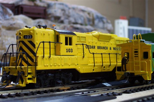

The GP7 has been remotored with another Athearn BB motor.
Dragenrider,Very nice! I have notice every club I have visited you still see a flock of Athearn GP7s…I suppose a lot of modelers including myself still like those rustic old GP7s.
Thanks, Brakie! I don’t know what it is about those engines. [%-)] They just seem to have an appeal like no other. It must be their toughness, good quality, and heft. Not to mention, they are so easy to work on or modify. BB GP’s are great!
