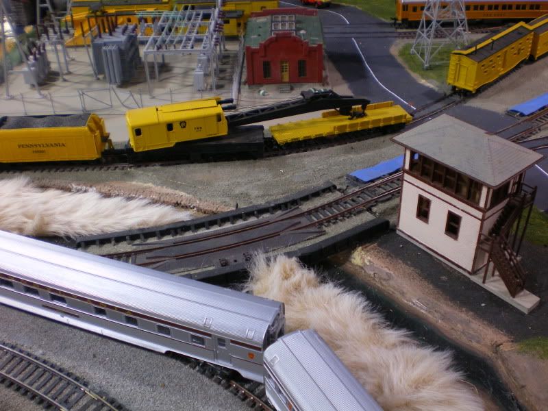

Nothing wrong with track work but used a re-railer for small stream bridge going into a yard.
THIS IS NOT COMPLETE since the extra boards are not installed nor are they painted but you get the idea. They can also be used on roads crossings with a little work.
